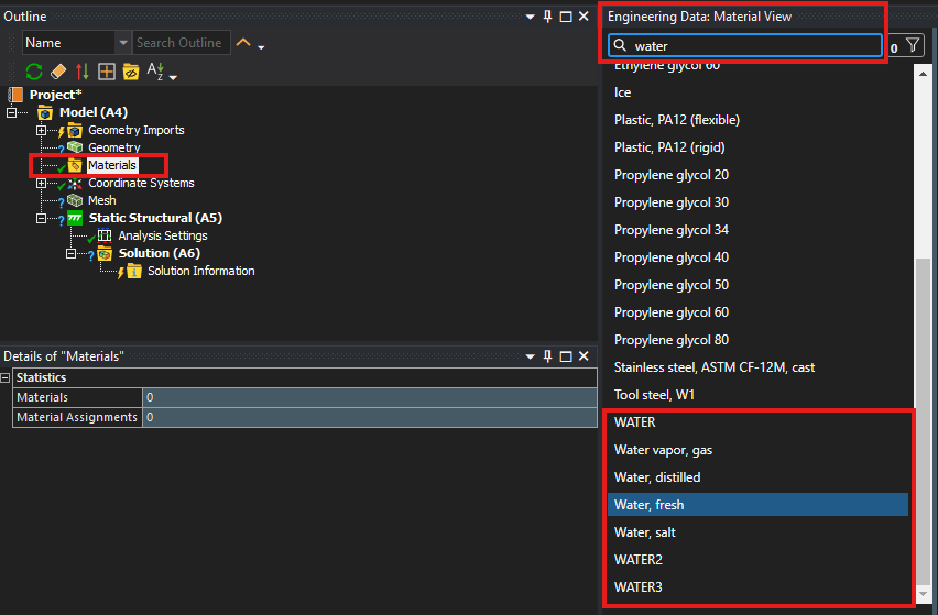

      I am performing Harmonic Response analysis and need properties of water for the analysis. How can I obtain the necessary properties for water?
    • soupadhy
      Please make use of the search bar for materials in Mechanical.
      Open Mechanical and click on material, a search bar will open.
