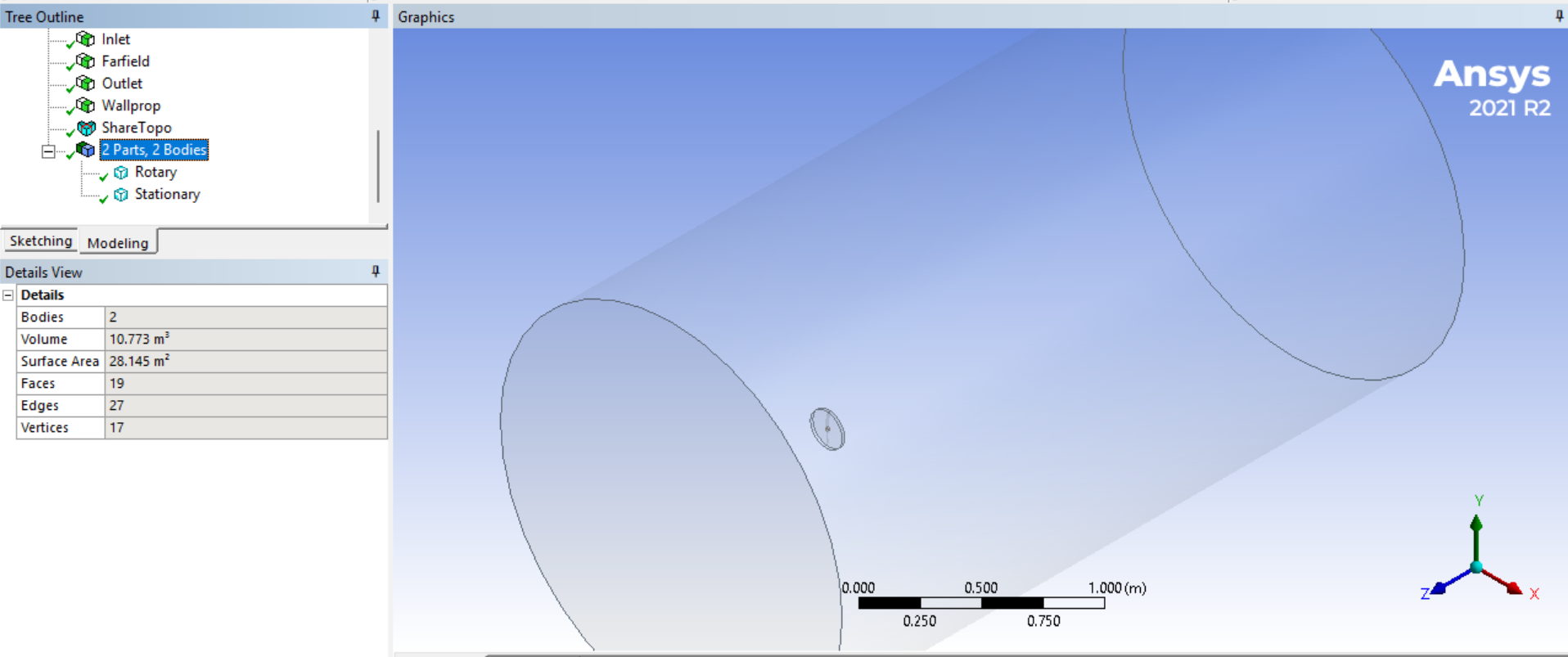

I try to simulate propeller in Fluent. I'm confussed about the boundary counditions.Â

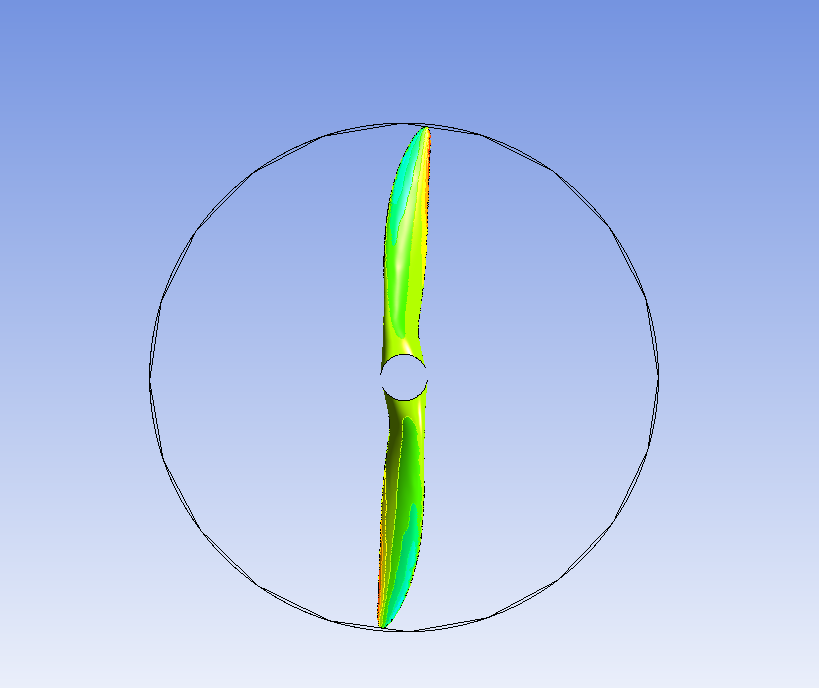

When i made the domain (both, rotary domain and stationary domain) with space claim there are inlet, outlet, farfield, wall-propeller, and 3 interface. When the simulation complate, there isn't rotating stream and the lift force always negative even i change the cell zone setup (i use MRF in steady state).
When i made the domain with design modeler there are inlet, outlet, farfield, wall-15, wall-16, wall-17, wall-prop (but it automatically define as hub only), some interface, and wall-prop interface (automatically define as the blade of prop). When the simulation complate, there is the rotating streamline and the error of lift force <10% but when i display the pressure and velocity countur it's like no stream over the propeller.What can i do to fix this situation? I also need to continue the simulation to get the accoustic SPL with FWH.

Forum ModeratorDon't use farfield with inlets and outlets. Where is the rest of the domain?Â

Subscribercan you explain about the rest of domain please?
I made the domain like this...
And about the farfield, i watched the tutorial and the domain set as inlet, outlet, and wall but i wanna try to simulate the propeller at the open space and it static, so i set the domain as inlet (0 velocity), outlet, and pressure-farfield (0.01 M). Can you recommend the domain settings?

Forum ModeratorIf you use inlet and outlet don't use farfield. If you use farfield don't use inlet & outlet. A zero velocity does just that: the flow is zero and that's generally not what you want. I think there's a VAWT example in Learning, that'll cover most of what you need.Â

SubscriberAh okay, i get it, thankyou sir
