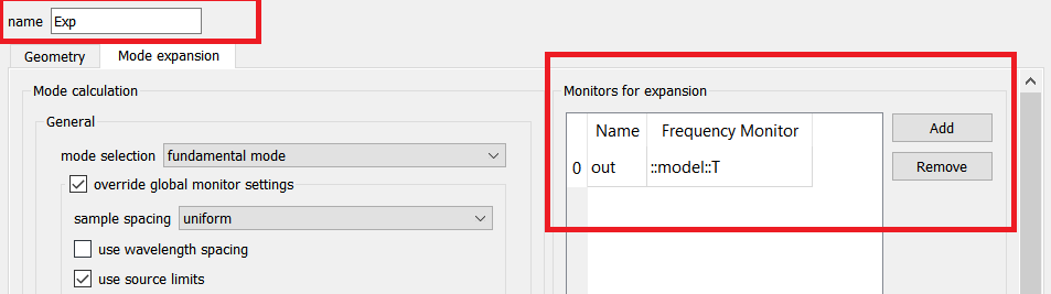

      I cannot figure out how to programatically add a frequency monitor to an existing mode expansion monitor. This is particularly problematic when creating the mode expansion monitor using a construction script in model, because then we cannot manually alter the expansion monitor.

      You can use the setexpansion script command to select a DFT monitor for expansion. For example, if the name of the DFT monitor is "dft", then you can use the following code:
      setexpansion("out","::model::dft");

      Generally, if you have a mode expansion monitor called "Exp" and the expansion results are "out" then you use the following code:
      out = getresult("Exp","expansion for out");
      But if you are using loop, it could be a bit tricky since the expansion results are a dataset. I believe the simplest approach would be to save the individual results of the output (expansion results) in different arrays. And if you wish, you can combine these results to form a dataset after the loop ends.
