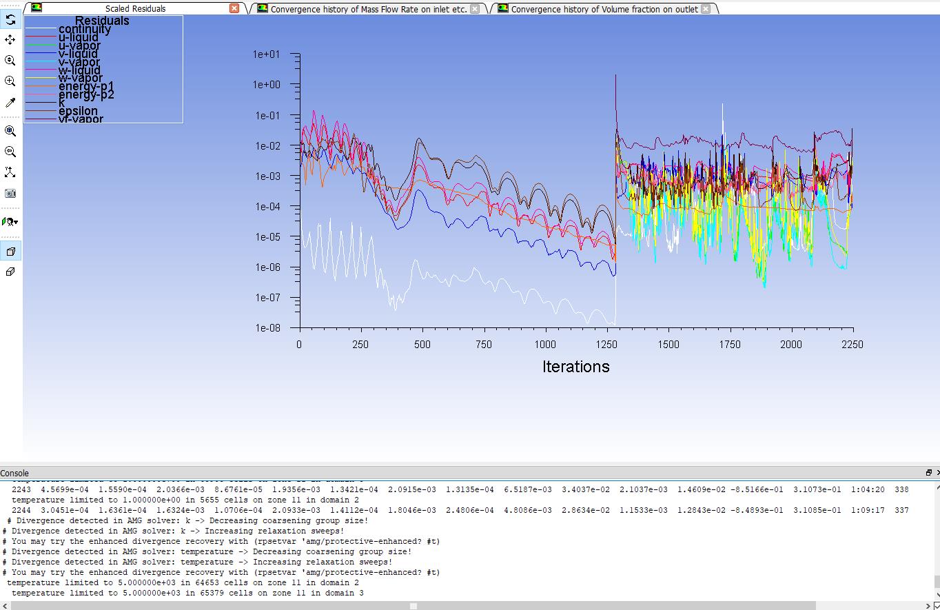

I have been dealing with multiphase flow inside the helically-coiled tube. My case is going to validate the case from an experimental study. The first try is, I do simulation in the single-phase to get the initial solution then continue with multiphase flow.
I set my simulation with Coupled solver and changed several URF to make it stable. But on the process, I have a message that my turbulent viscosity is limited to viscosity ratio and also temperature limited then turn the simulation into diverged with divergence detected in k, vof-1, and pressure coupled.

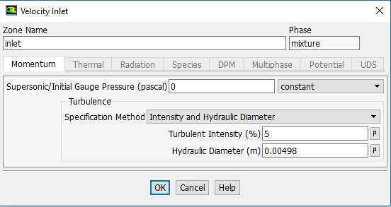

I use RPI wall boiling model in my case with the second option (Non-equilibrium Boiling). In my BC, in the inlet I put the value of T.I: 4% with my hydraulic dia. and the outlet is gauge pressure 0. The heated wall is set up based on the heat flux in the experimental case, and I put adiabatic wall to ensure fully-developed flow when entered into the domain.

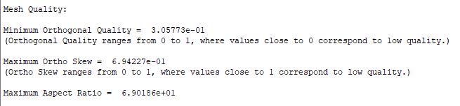

Forum ModeratorCheck mesh resolution (is it fine enough) & quality, inlet conditions plus the various material properties & operating conditions. Also check the time step you used - it may be too big.Â
As we've commented before, please include pictures.Â

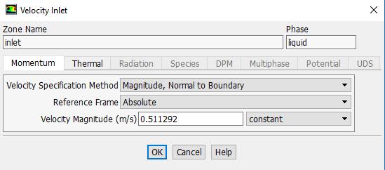

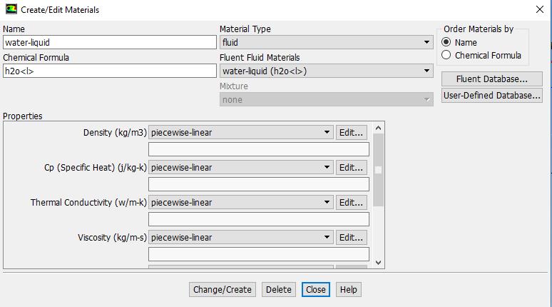

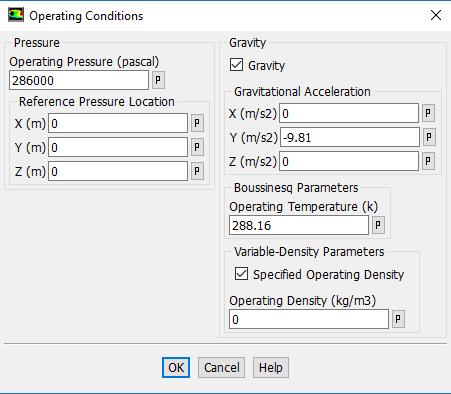

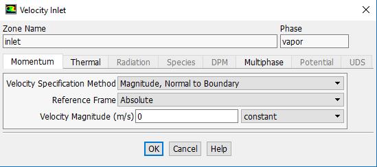

SubscriberDear Rwoolhou,
Kindly refer to the attached image in this message, I have shown you several parameters inside of the domain.
For inlet temperature in vapor area, I put my saturation value of the bulk flow. Also for water-liquid and water-vapor properties I specify with function of temperature using piecewise-linear option and for the standard state enthalphy, it is calculated from the saturation value of the fluid.

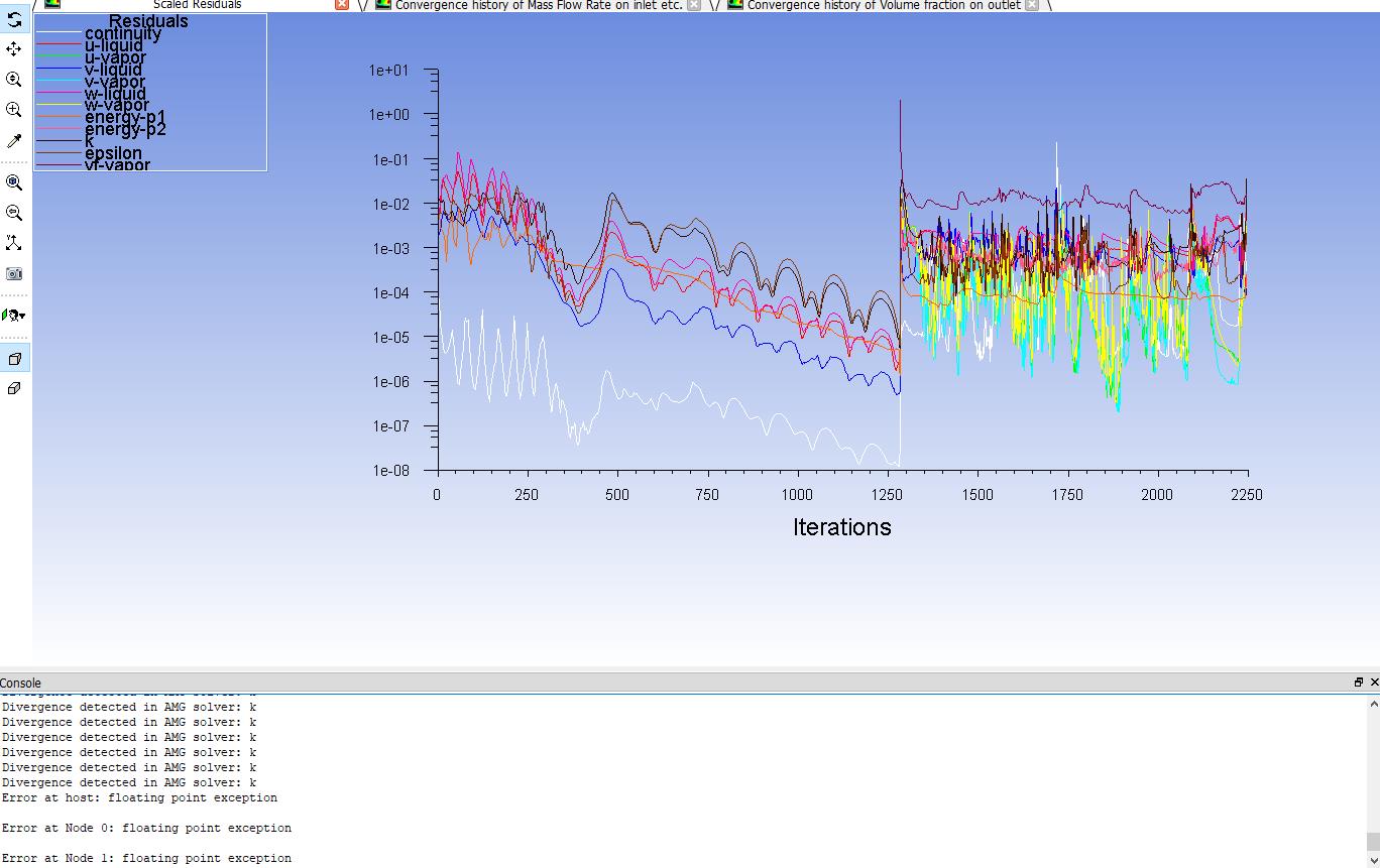

FYI: I also changed my turbulent intensity from my previous simulation from 4% to 5%, but the result is still diverged with a message that mentioned about temperature limitied and diverged detected in AMG solver: k

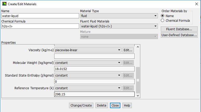

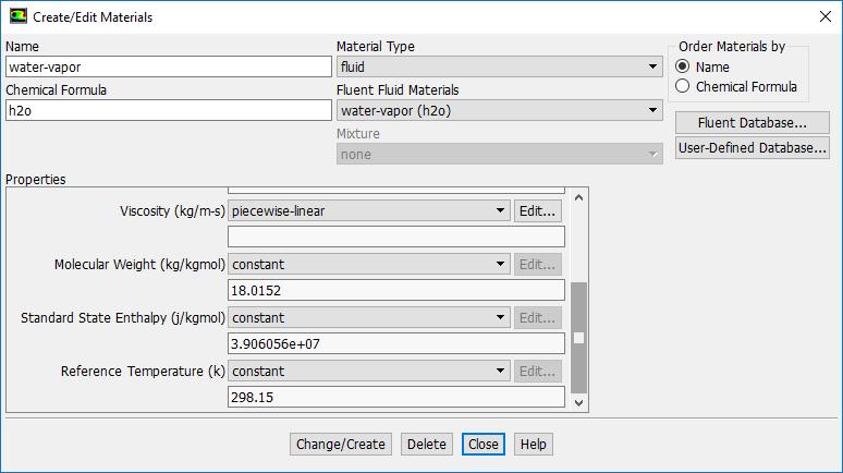

Ansys EmployeeCheck if the reference temperature under material panel corresponds to saturation temperature. Avoid fine mesh near the wall. Start as conservative as possible by ramping heat flux at walls and reducing vaporization mass urf.Â
April 1, 2019 at 2:33 am
farizanluthfi
SubscriberAs my experience, I put the reference temperature corresponds to saturation temperature is resulting in diverged value. So I change the reference temperature into 298.15K. For URF, I also give some modification to the URF since the first iteration. In addition, the mesh near the wall is also acceptable.

SubscriberI have been modified the URF with certain values and always get diverged for k and epsilon. Also, I have a warning message on turbulent viscosity limited and temperature limited in the FLUENT. I have been searched in the forum to overcome the issue but still have no significant result on it.

For operating condition, I put my operating density is equivalent to the saturation value. I have also started my heat flux with 70% from the reported heat flux and now it's in ramping into 75%. For the discretization method, I have changed into second order for almost equation except for vol.fraction into QUICK.

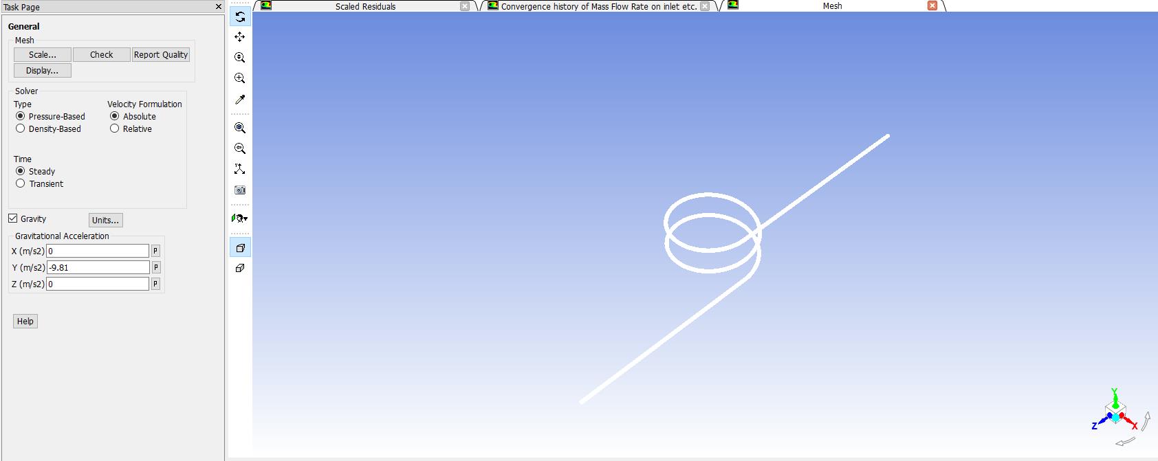

Ansys EmployeeDo not reduce energy URF for non pseudo transient approach. Try ramp the heat flux and coarsen the mesh. How does you geo look like? Please highlight in the picture the gravity direction. -

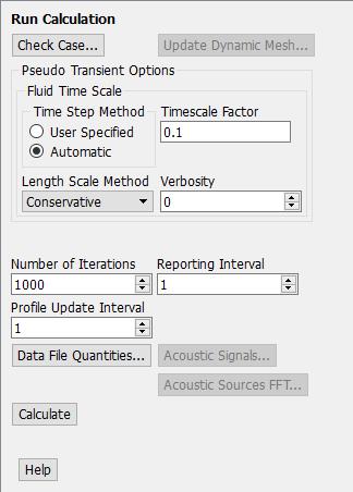

SubscriberI am running the simulation for pseudo transient approach, because when I just use steady-state, it will get diverged easily. I have attached the pics in the message below. Thank you so much Sir.
Best Regards,
Luthfi Ady Farizan Haryoko
It could be seen in the pics that the gravity is in Y-axis direction. The inlet region is in the below helical coil and the outlet region is in the upper helical coil. The adiabatic length is applied for making fully-developed flow in the domain. I have been employed the adiabatic length in the extended region for inlet and outlet.

Ansys EmployeeThat is not really an application range for RPI Boiling method which has been designed and validated for vertical heater. The wall heat flux partitionier will work. However if you have horizontal heated walls, is more likely that you have pool boiling than forced convection boiling. The correlations for the submodels of the RPI model were derived for forced convection cases
