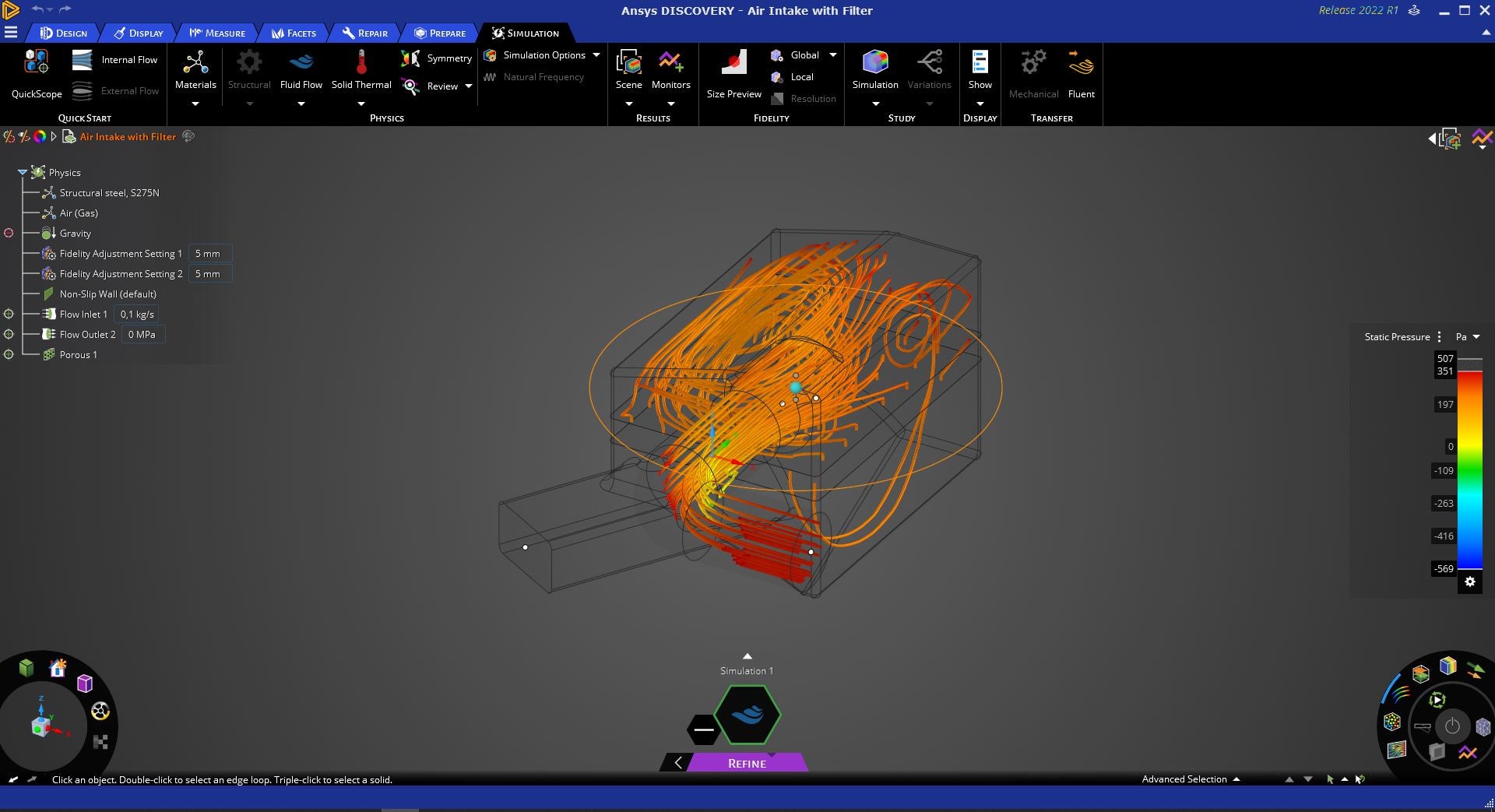

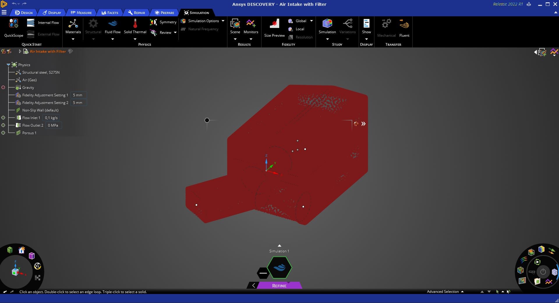

      I try to do the Air Intake tutorial with Filter Getting Started in ANSYS Learning Hub and have lots of problems. I am working in analysis mode.
      1) I can not see the mesh. When I turn on the mesh, there is only red dots (Simulation is finished: SID is completely green)
      2) I can`t see the streamlines from the inlet to the outlet like in the tutorial .

      1. The issue you are seeing with Mesh is a known issue.
        Please check this page for a solution to that.
        Discovery Refine : Display issue (Red dots) when viewing Mesh - Knowledge Base - Ansys Discovery Forum

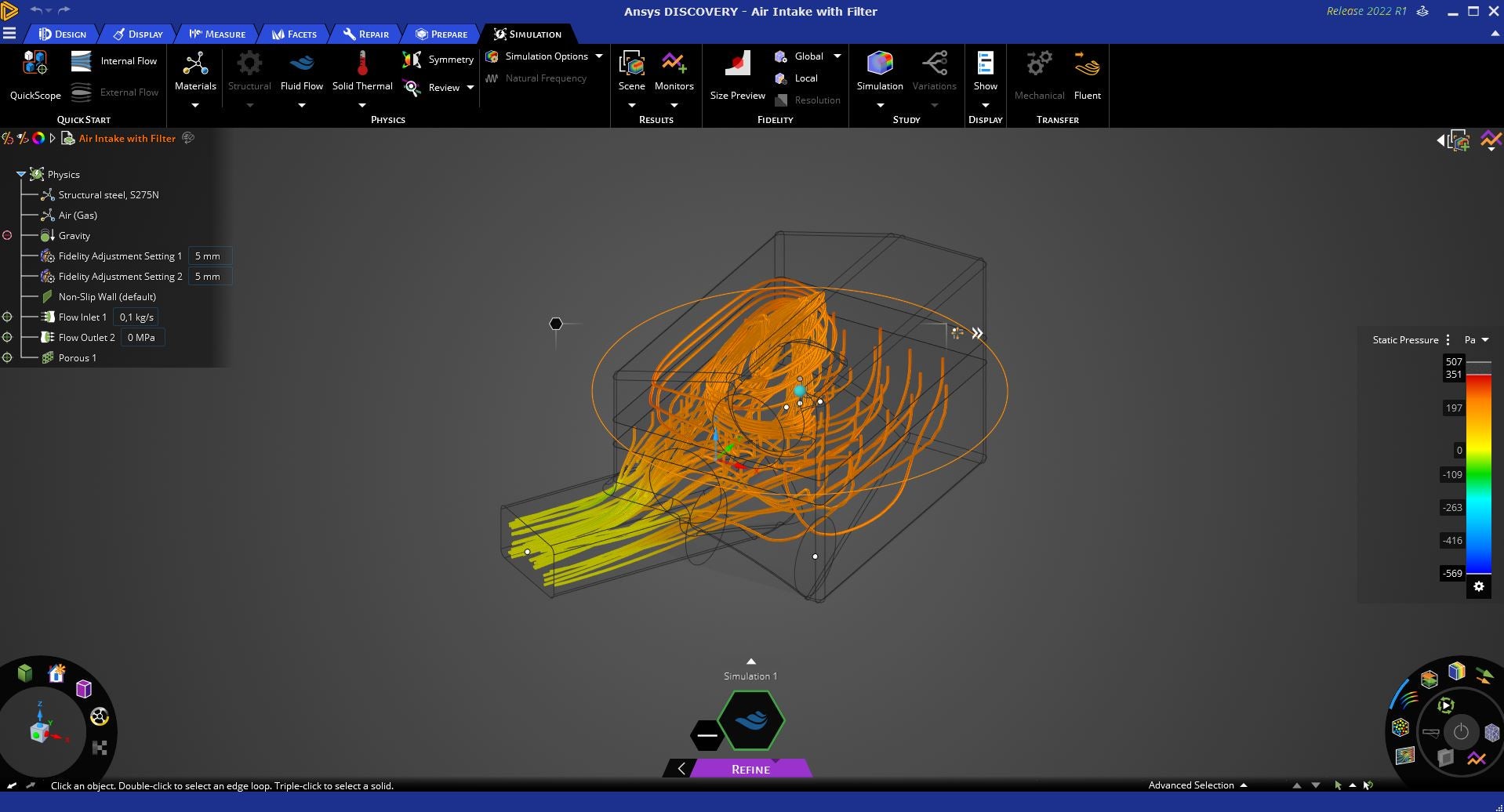

      2. I see from the image that the emitter for streamlines does not seem to be set at the inlet.
        Please use the blue ball in the center to move around the emitter for streamlines.
        Refer Video attached.

        1. This issue occurs only with the NVIDIA Graphics driver version 5xx.xx, so you can revert back one version to avoid this issue.
        I have updated the Nvidia driver to the lastes one because with the older version I have a problem with Explore Mode. The Explore Mode is not exist with the older version of NVIDIA driver.
        2. The other option is to disable the INTEL GPU from the Bios and then re-install the NVIDIA driver update for version 5xx.xx.
        (Please perform these changes with the help of your company's IT professional.)
        My company´s IT won´t  do it.
        Is there more solution to fix the mesh problem?
