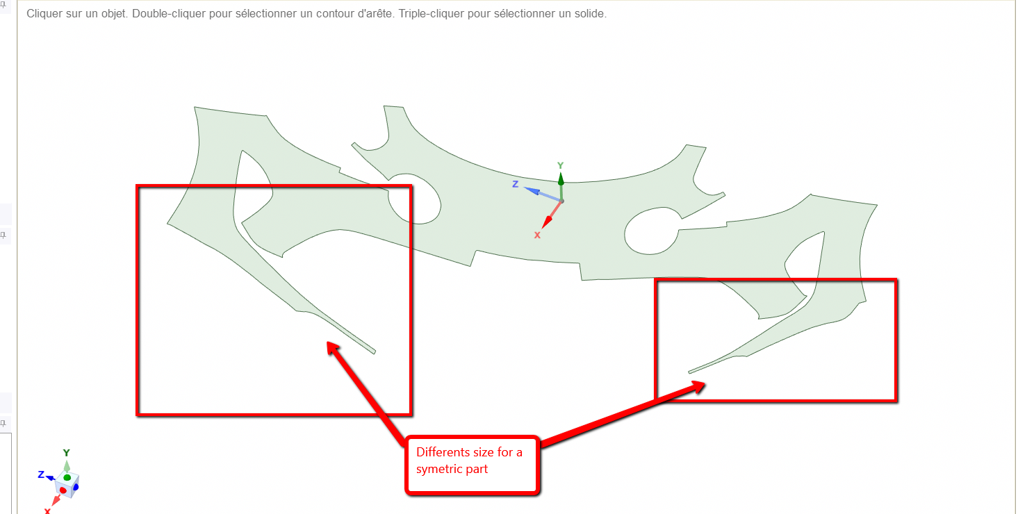

      They have a scanner to scan the bumpers of cars, import the scan into spaceclaim to do the reverse engineering with the skin surface tool.
      And finally, he realizes the unroll of the result to know the flattening for the cutting.
      The problem is that the unroll tool gives inconsistent results.
      Here is a video example to illustrate the problem : https://www.screencast.com/t/J2rjoqCidMv
      Here a link to download the file : https://we.tl/t-yC8lt6spK6
      In 3D, the distance between two points is about the same (watch the vidéo), but when you do the unroll and make a measurement between the two points in question, there is a 20 cm gap.
      The result is therefore absurd.
      The customer is blocked and has lost confidence in the application, do you have a solution to bring to this problem?

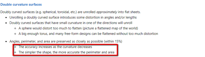

      Now coming to your question, the geometry that you are working with seems a little complex for achieving the highest accuracy with 'unroll'. In Discovery SpaceClaim help documentation (place the cursor on 'Unroll' and press F1) it is mentioned that simpler the shape higher the accuracy of the perimeter and area.
      In the geometry that you are working with, there are multiple curvatures hence the accuracy of 'Unroll' seems to have reduced. A workaround I'd suggest is to divide the surface into few parts and then use the 'Unroll' tool individually on these parts.

      Its problem is not necessarily the 15% deviation (as mentioned in the help) that the unroll can give, but rather the fact that the result is not at all homogeneous, for example you can compare the left and right side as can be easily measured on the file I sent you or the image bellow.

      For information, I realise different test for this case, it seems that when you merge the surfaces together, the result of unfolding is better. If you have any ideas that can improve the quality of the deployment, feel free to let me know !
