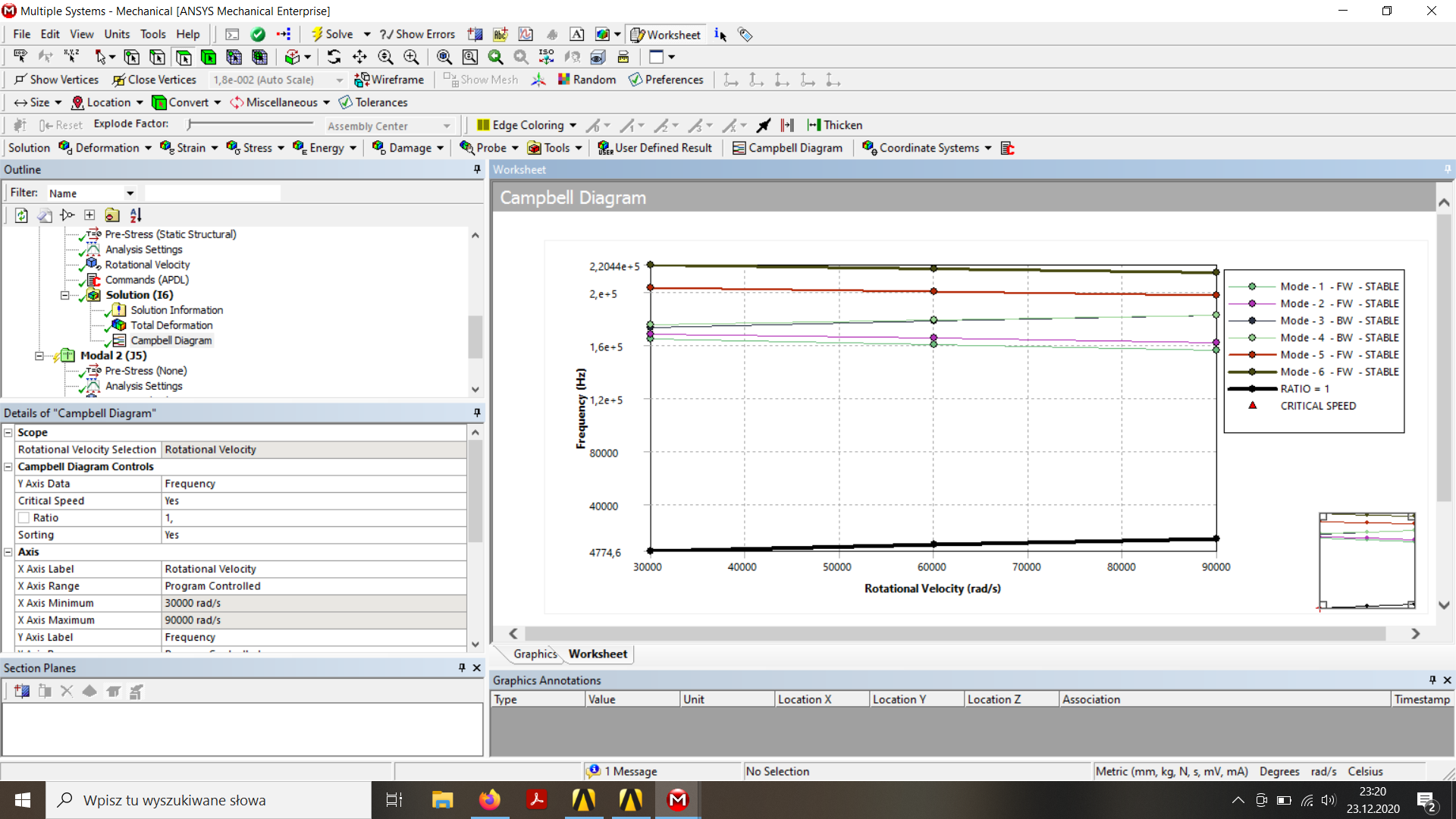

SubscriberArraythank You for a comprehensive response. I couldn't open the attachment because I'm a user of a 18.2. release. However, your description encouraged me to try some settings. When I switched to rotating reference frame, it turned out that I am able to plot the Campbell diagram. I didn't try this before, as I have read in some guide that only stationary reference frame gives this possibiity. Anyway, the procedure conducted in rotating reference frame works, but now the problem is that FW frequencies decreases with increase of rotational speed and vice versa:n

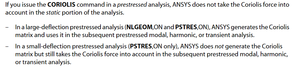

nI guess I should take Your advice and create a few modal analyses, obtain modes frequencies and draw a campbell diagram by myself in excel, because, suprisingly, this approach provides expected results. nYou have mentioned the PSTRES command. The explanation of use of it gives ANSYS Advanced Analysis Techniques Guide for release 10.. In chapter 8 You can find this information: n
However, I typed this command to get non-zero stress and deformation in stationary reference frame with included coriolis effect. nI feel quite confused about the results of our investigations on this issue and I guess I am going to try figure something out tomorrow. By now, thank You very much for involvement and wish You Merry Christmas. n
