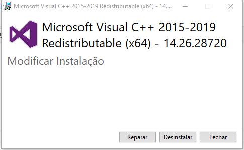

SubscriberI can't solve this problem on my laptop, i have already reinstalled, disabled antivirus to reinstallation, and installed all Microsoft visual C++. What can I do next?

June 2, 2020 at 8:55 pm
tsiriaks
Ansys EmployeeWhen you tried to manually install these two
MS VC++ 2017 Redistributable x86
MS VC++ 2017 Redistributable x64
what did it say ?

tsiriaks
Ansys EmployeeYou will have to figure out what software (or Windows update) installed this MSVC++ 2015-2019 on your machine.Â
Then, see if is possible to uninstall this for a while, so that you can run the installation of these two
Make sure they are successful. Then, you can re-install the MSVC++ 2015-2019 (with exact same build) back.
June 7, 2020 at 4:40 pm
Ferdinando1995
SubscriberI got it! I discorvered what was my problem.
I've uninstalled all the 2015-2019 versions, allthough i found a 2019 version installed that i had not found before and uninstalled it. Then i run again the setup and i get it, finally!
Note: i had to copy the "prereq" files from the installer folder to: C:Program FilesANSYS IncANSYS Studentv201prereq
