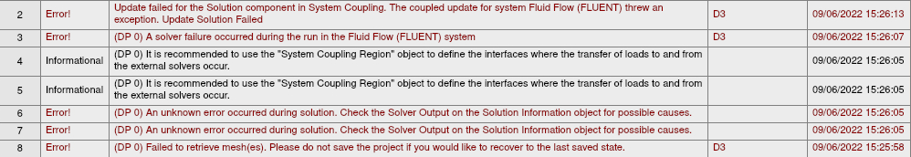

| Warnings were found during data model validation. Â Â Â Â Â Â Â Â Â Â Â Â Â |
| Warning: Participant Transient Structural (CouplingParticipant:Solution 1) Â |
|   has the ExecutionControl 'Option' set to 'ExternallyManaged'. System   |
|   Coupling will not control the startup/shutdown behavior of this     |
| Â Â participant. Â Â Â Â Â Â Â Â Â Â Â Â Â Â Â Â Â Â Â Â Â Â Â Â Â Â Â Â Â Â |
| Warning: Participant Fluid Flow (FLUENT) (CouplingParticipant:Solution) has |
| The variable locations of force and heatflow variables for all Fluent    |
| participants are set to 'Element'. Make sure that this is consistent with  |
| the setup within Fluent. When importing the SCI file (this includes running |
| inside Workbench), you can control the locations of these variables by    |
| using the 'SYC_FLUENT_CONSNODAL' environment variable. For more       |
| information, refer to System Coupling User's Guide. Â Â Â Â Â Â Â Â Â Â Â Â |
Awaiting connections from coupling participants...
Elapsed time: 5 min. Still awaiting connection from: Solution 1. If you feel the participant(s) should already have connected, check participant logs and/or abort the run.
| "System coupling solution stopped before all participants connected. User  |
| has aborted the run" Â Â Â Â Â Â Â Â Â Â Â Â Â Â Â Â Â Â Â Â Â Â Â Â Â Â Â Â |
Transcript output stopped: 2022-09-06 15:15:52
Awaiting connections from coupling participants... done.
|                Build Information                |
| System Coupling                               |
| Â 2022 R1: Build ID: 3043b37 Build Date: 10 November 2021 11:15:32 Â Â Â Â Â |
| Fluid Flow (FLUENT) Â Â Â Â Â Â Â Â Â Â Â Â Â Â Â Â Â Â Â Â Â Â Â Â Â Â Â Â |
| Â ANSYS Fluent 22.1.0, Build Time:Nov 29 2021 12:13:18 EST, Build Id:10213, |
| Â OS Version:lnamd64 Â Â Â Â Â Â Â Â Â Â Â Â Â Â Â Â Â Â Â Â Â Â Â Â Â Â Â Â |
| Transient Structural                             |
| Â Mechanical APDL Release 2022 R1 Â Â Â Â Â Build 22.1 Â Â UP20211129 Â Â Â Â |
|  DISTRIBUTED LINUX x64   Version                      |
| Â Â Â Â Â Â Â Â Â Â Â Â Â Â Â Â Â Â Â Â Â Â Â Â Â Â Â Â Â Â Â Â Â Â Â Â Â Â |
|              Analysis Initialization              |

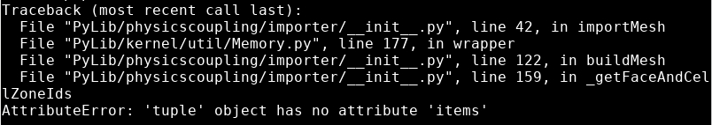

| Failed to retrieve mesh(es). Â Â Â Â Â Â Â Â Â Â Â Â Â Â Â Â Â Â Â Â Â Â Â Â |
Transcript output stopped: 2022-09-06 15:44:42

 *** ERROR ***              CP =    1.867  TIME= 15:44:42
 A System Coupling error occurred while the request AssignToken was   Â
 being served.                              Â
 NUMBER OF WARNING MESSAGES ENCOUNTERED=      1
 NUMBER OF ERROR  MESSAGES ENCOUNTERED=      1
 ***** PROBLEM TERMINATED BY INDICATED ERROR(S) OR BY END OF INPUT DATA *****

November 22, 2022 at 1:52 pm
Rahul
Ansys EmployeeHi,
it is recommended that you build up to the final two-way analysis incrementally, progressively adding complexity with each step. Check if your participant solutions works fine with representative loads. Look at the transcript files for errors if any.
Please refer Building a Coupled FSI Analysis from Decoupled Participant Problems (ansys.com).
November 22, 2022 at 4:58 pm
georgia.stuart
SubscriberThe workbench project I'm using runs fine on a windows desktop. The problems only occur when it's on Linux. What do you recommend?
November 23, 2022 at 11:14 am
Rahul
Ansys EmployeeHi,
Have you tried running other system coupling projects on Linux? Is this error specific to this project?
is that file built in v221 in windows or previous version used for that?Â
Please try running tutorial Oscillating Plate FSI Co-Simulation with Partial Setup Export from Workbench (CFX-Mechanical) (ansys.com) on Linux.
