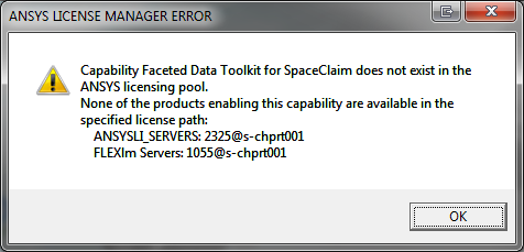

A client of Discovery spaceclaim enterprise with 3 floating licenses from Spaceclaim. He doesn't have the facet module.
When it starts Spaceclaim, it has the attached error message ?
So the error message seems logical, on the other hand, the message is there each time Spaceclaim is opened. How to stop the message?ÂBest regard

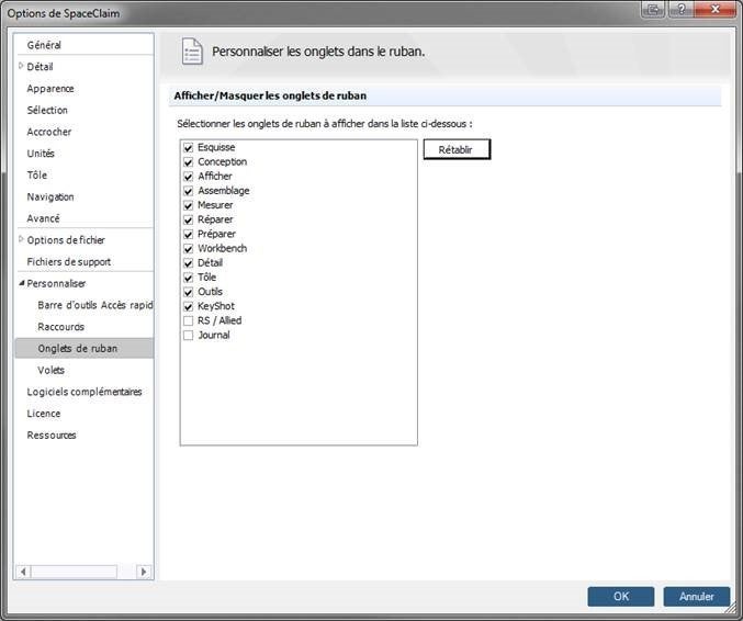

Is the option for the Facets ribbon tab set to active in SpaceClaim Options > Customize > Ribbon Tabs?Â
We're basically looking for any setting that would try to obtain the Facets tools license.
January 29, 2020 at 12:52 pm
Yohann Biran
Subscriber-

Floating license here is not picking up the STL Prep option. Any ideas?
March 3, 2020 at 7:15 pm
ANSYS_MMadore
Forum ModeratorIt seems the error is correct, they don't have the license, so they would see the error. They can try unchecking the "STL Prep" box under "License" within the SpaceClaim Options?
