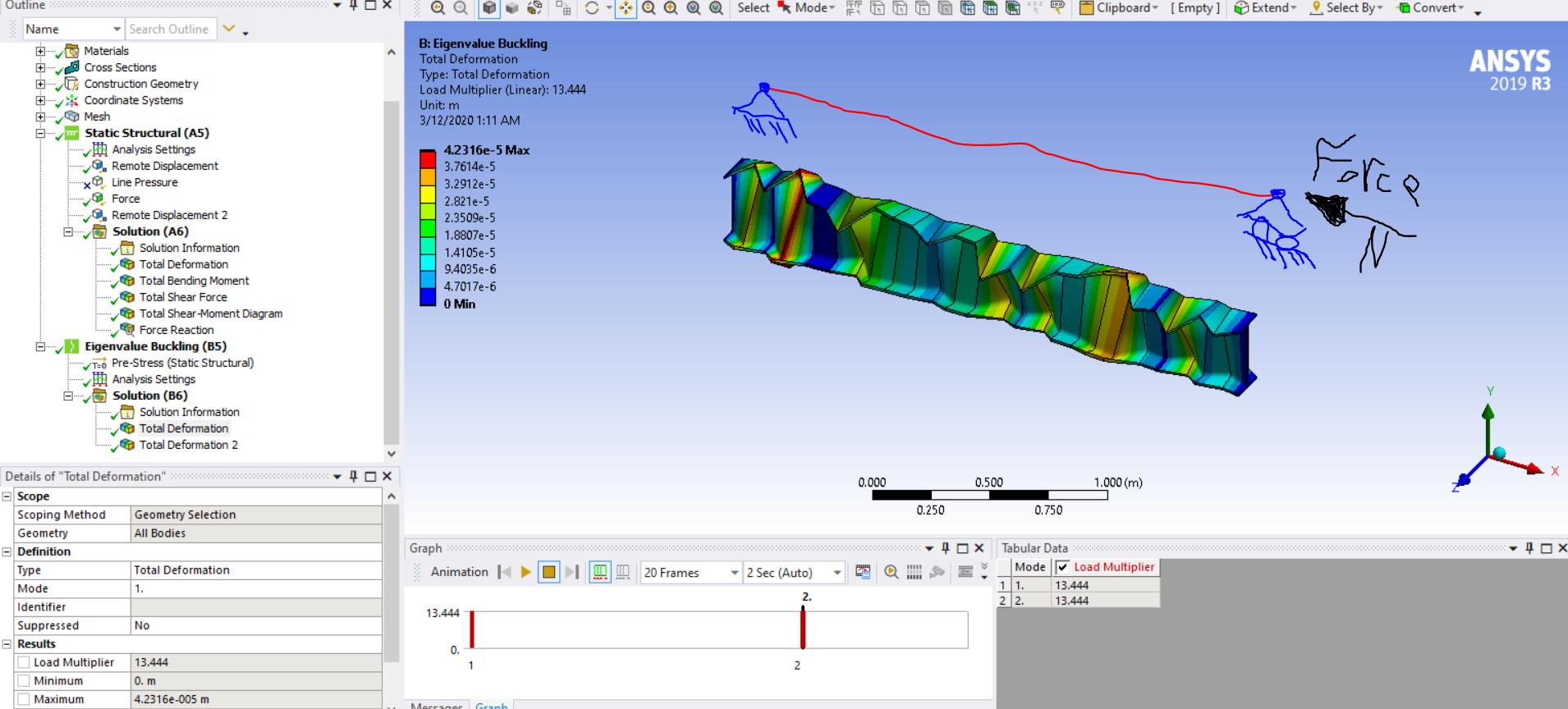

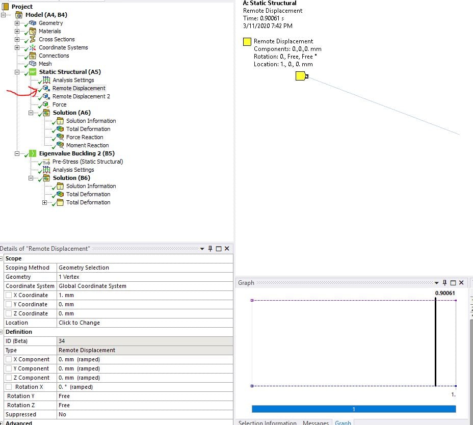

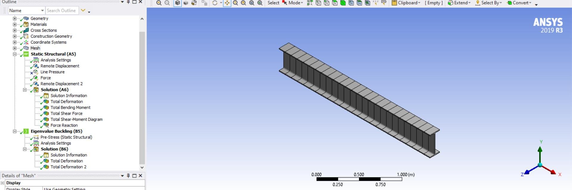

 I have a problem with modelling a simply supportd beam due to calculate eigen valueÂ
actually the problem is with the boundary conditions .... beam is defind as line body ... the first end is defined through Remote DisplacementÂ
(Displacement X Y and ZÂ are 0 , Rotation X is 0 ,Rotation Z and Y are free) the second end is defined too through Remote displacementÂ
(Displacement X is Free ,Y and Z are 0 , Rotation X is 0 ,Rotation Z and Y are free)....
but unfortunately the defomation form appears not logic .... could anyone help me to define the probelm please .... -

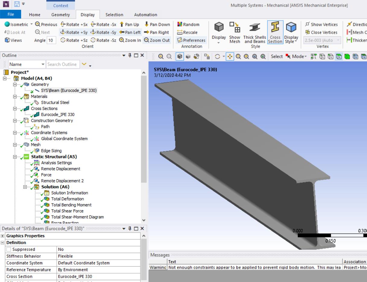

Ansys EmployeeHi Masri,
Does the solver show you warning "not enough constraints appear to be applied to prevent rigid body motion“? Your beam can rotate freely in the z and y direction and that may cause an issue.Â

THnx for ur replying
 yes i have got this message as Warning,,,, but that is the real situation that i want to represent... beside when i prevent the beam from rotation around Y and Z axis then it produces momentum at the ends and this is not the same Euler situation that i need to study .... -

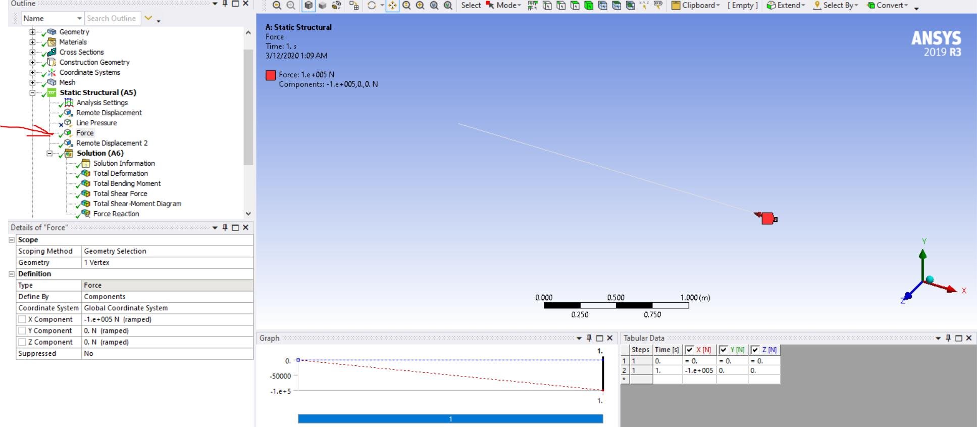

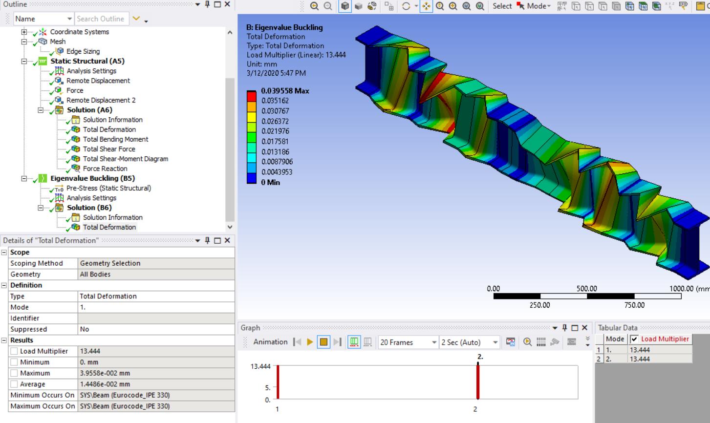

Based on the image you shared, can you please try changing the force to 1N in the static structural analysis? It is likely that the beam has no longer small deformation when you apply such a large load.Â
Usually what we do is apply a unit load in the static structural module, and the buckling load will be whatever the load amplifier is in the eigenvalue buckling analysis.

SubscriberHi Wnlong,
I have changned the force from 100,000 N to 1 N ..... The load the load amplifier changed from 13.44 to (13.44 X 10^5) .I dont think that is related with the load amplitude ..... I think there is a problem with a boundry conditions but i cant define it ..... could u please show the ansys file that i uploaded to help me defining the problem?

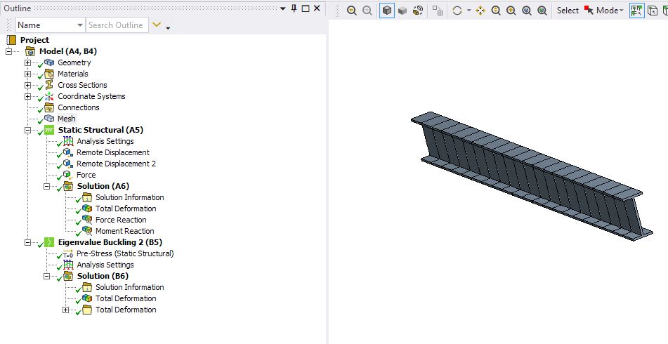

Sorry due to the company policy I cannot download any attachments from the student community. So we can only communicate through images. It looks to me that all your BCs are the same as mine... Do you mind showing more information about the analysis settings and the geometry information? What is in that construction geometry?

Thanks for replying. When I try higher natural frequency I see your behavior too (I apologize for not capturing it the first time, plus, my remote displacement location was wrong, it was not set to the end of the beam).
I think the reason could be the mesh size being too big and not able to capture the wavelength in high-frequency mode. Could you please try using a very refined mesh 5mm?

Please try to set the max mode to find to 10 (a large number), I think if you only request 2, the second one will give you the highest frequency? (I will double-check and follow up with you on that).
