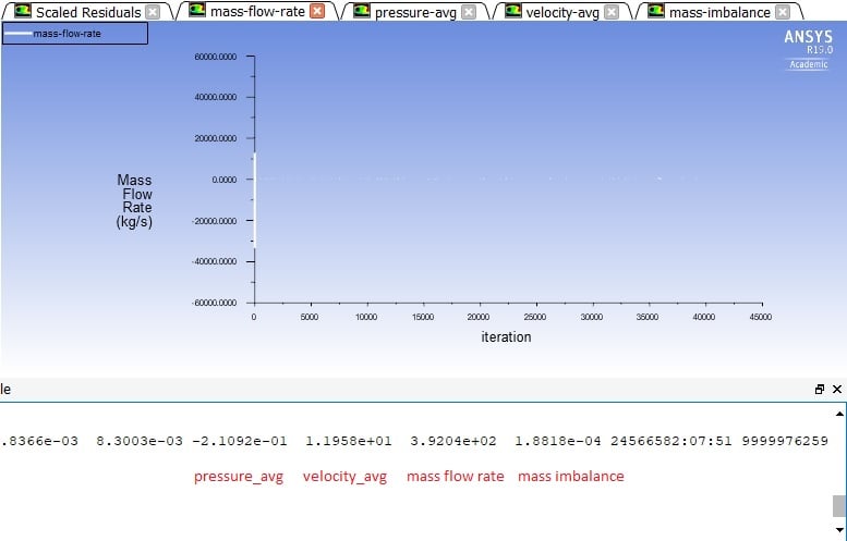

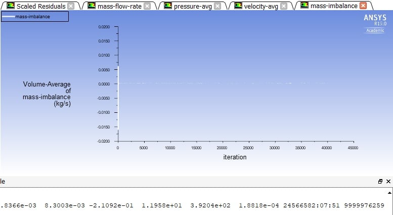

    • riteshnw
      Dear Karthik,nI performed the si,ulation. I started the simulation with first order upwind and when the residuals and other monitor parameters were stable, I continued with second order upwind and after that I reduced the URFs.nThe mass flow rate and mass imbalance seemed constant throughout the simulation bu there were some up and down variations in avg. pressure and avg. velocity.nPlease find the images in attachment and let me know if they can be considered as good solution.nThank you in advance.nnRiteshnn
    • Karthik Remella
      Administrator
      Hello,nI'm not able to download any attachments from your post. Could you please insert them directly into your post? You can use the upload image option at the bottom.nWhat near wall model are you using? And what is your y+ value?nAlso, what is the final goal of your simulation?nKarthikn
