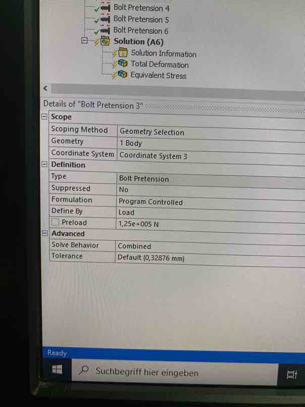

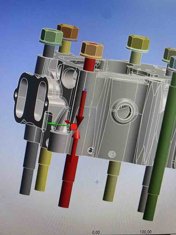

I need to simulate three plates being hold together by 6 bolts.
The bolts are cylindrical and threaded on the top and on the bottom part, they are secured by a 600Nm torque and by calculations (given the M24, so the diameter) the preload should be around 125kN.
Now this being said, as contacs I put as bonded the bottom part because it is blind and goes into a thread of the lower plate, and bounded with the nut on the top thread.
Regarding the rest of contact, so between nut and washer and washer and plate as weel as between plates i used frictional contacts with coefficient 0,2.
If I mesh and run the simulation I get values over the strenght of the steel which seems not reasonable with high peaks in random spots regarding on the type of mesh I use.
So I was thinking i may be applying the pretension in the wrong way, or am I wrong anywhere else?
Any type of help is welcome.
Attached are screenshots.
Thank you in advance,

SubscriberCheck that the 'bonded' contact face is not within the preload application faces
September 11, 2023 at 12:59 pm
Pasquale alessio Lentini
SubscriberI did, I changed the application point of pretension, but it does not get better.
Regarding the contacts, is it okay if i leave it frictional or also bonded would make sense since i am interested just in the stresses in y direction.Â
I cannot find the problem, it is a basic static simulation, can anyone help?
