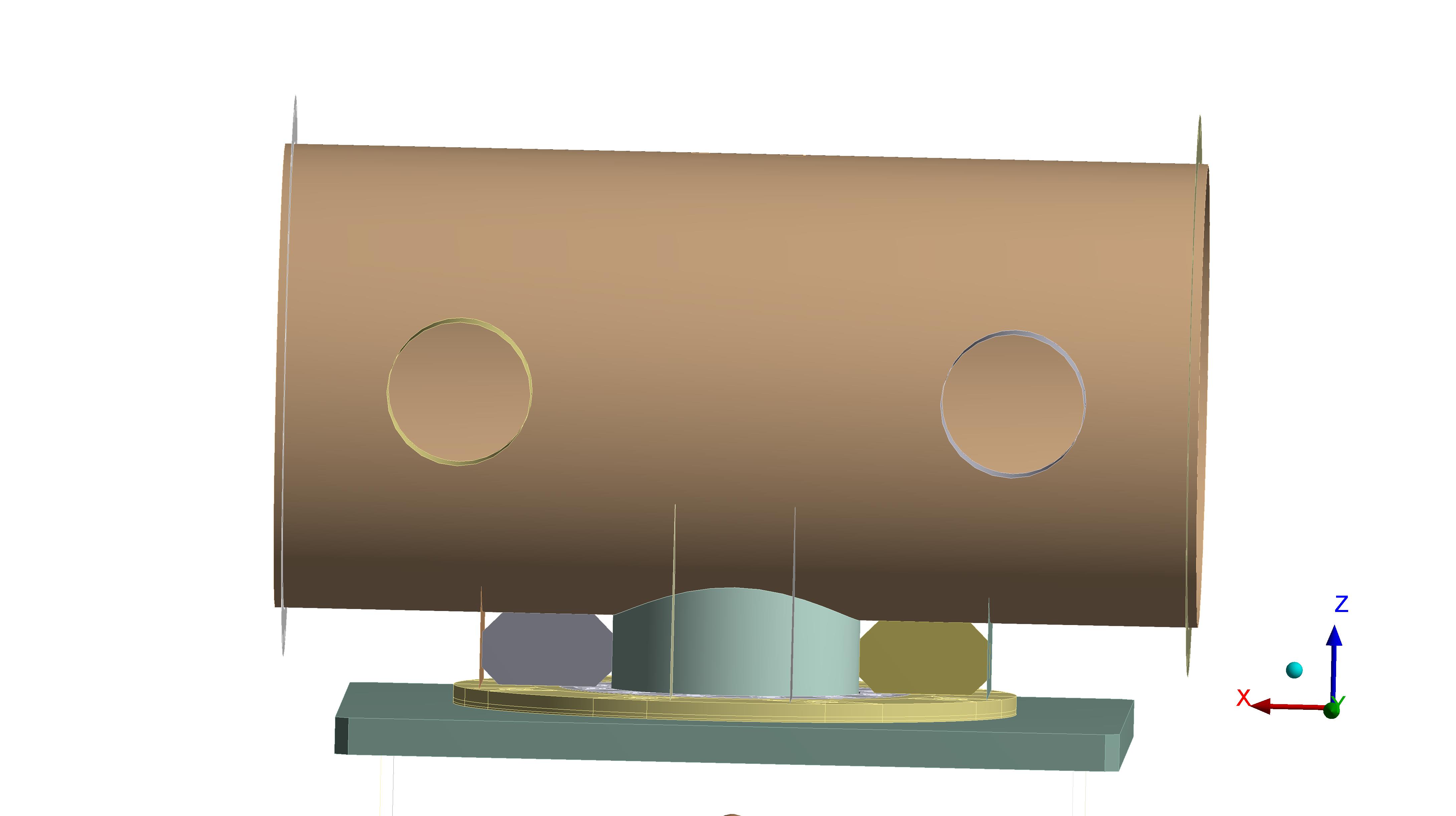

I have a support structure upon which there is a steel plate. This plate is connected to another plate. Between these two plates, i have used beam connection from body-body connection and there is frictional contact between the two plates.
I am applying the bolt pretension on these beam connections.
I am expecting that the bolt pretension force will act in compression but when i run the simulation, bolt pretension is acting in the opposite direction. The below screen shot shows the deformation after 2 sub steps but it is clearly seen that the two plates are separated because of the bolt pretension.
Can anybody help me here? I don't know what i am doing wrong here.

SubscriberHello, I was working with a bolted flat cover of a cylindrical pressure vessel, and i had the very same problem, and if my memory don't fail, what i had to do was creating a new coordinate system on the bolt, and select that coordinate system at the Bolt Pretension manager.Â
Worth noting that I simulated just a part of the solid, and use cyclic region symmetry.Â
Good luck.

Thank you for your quick response. In your screen shot i see that you have solid body of a fastener. But in my case i am using body-body beam connection and when i apply bolt pretension on beam connection, it is not possible to choose the coordinate system as far as i know. Do you know how to select coordinate system for the beam connection?

I can not share the modal because of confidentiality. There is a frictional contact between the plates and offset is set to default. I used line bodies for the bolt shank and used joints to connect line bodies to the plates. Now it is working as expected. Still i don't know why it was not working with body-body beam connection.Â

Thank you for sharing this video. I use the method explained in the video and it is working as expected now.

If you apply an offset to the contact definition, that will be applied in step 1 at the same time the pretension load is ramping up, so they will both be present at the end of step 1.

Thank you for your help. So if there are mid surfaces connected by the bolts in the assembly and in the contact generated between the mid-surfaces, offset value is applied then body-body beam connection won't work. Is this true?

Yes, if you have two midsurfaces, the contact has a Shell Thickness property that can be set to Yes so that it put the offset in for you automatically.
If the plates become midsurfaces, you do the same with the line body. Make a fixed joint between the vertex of the line body and the circle in the midsurface, and repeat for the other midsurface and the other end of the line body. The pretension can be applied to the line body the same as you have already done.
