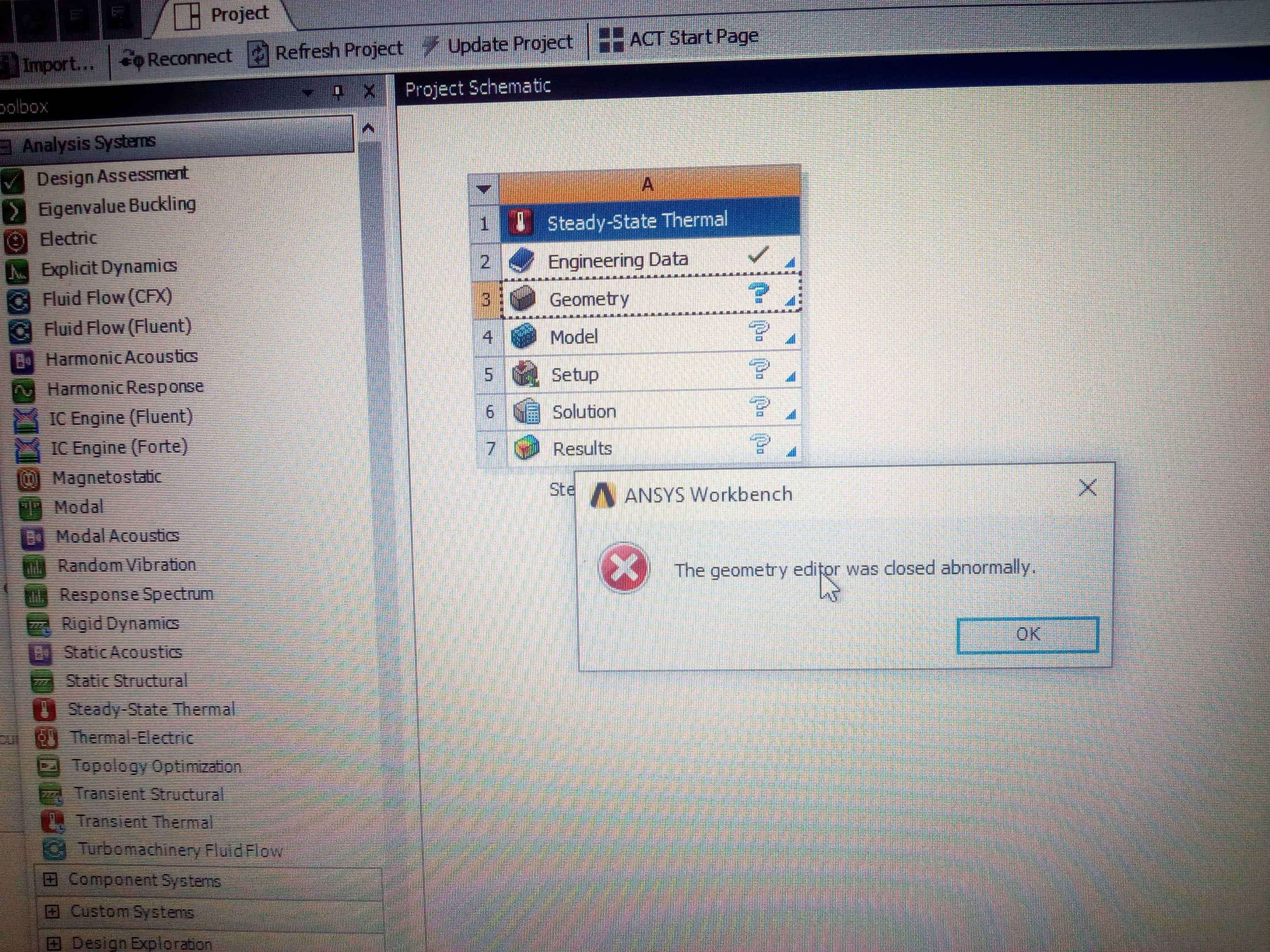

      I have downloaded "ANSYS 18.2 (3.9 GB) Student version" to learn ANSYS by online course started by Edx but unfortunately I wasn't able to open the geometry. Every time I open it I get the error "Geometry editor was closed abnormally" .
    • Keyur Kanade
      Please check if you have read write permissions to respective folders.
      Please run set up with 'Run as Administrator'.
      Keyur
    • rangushiva
      Yes, i run set up with 'Run as Administrator' but no use, same error displayed. Please help me what i need to do?

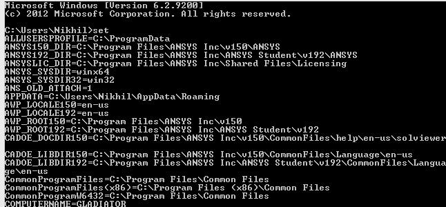

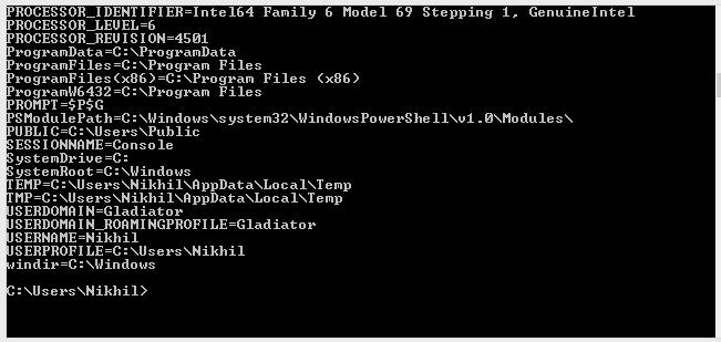

      NikhilSM, please create a new thread and reference this one. We can work on your issue there. Please also provide the following info in your new post.
      Are you able to launch stand-alone SpaceClaim ?
      Open CMD Prompt, then issue the following command
      set
      and post the output of it.
    • dancab
      Hi, I was having the same problem ("Geometry editor was closed abnormally") and following ragushiva message above I found a solution that worked for me. However I can't seem to be able to start a new discussion to post it and share it with everyone.
    • NikhilSM
      Geometry closes abnormally at same time spaceClaim open up
      Here is screen shot of CMD commant - set
