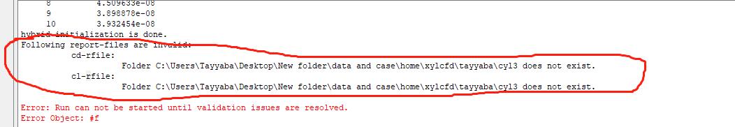

      Hi, I am running fluent 19.1 in batch mode for flow over circular cylinder and want to have report file of Cd and Cl. I have these files on running fluent on my desktop but in batch mode I did not get these files and it does not show any option to give it the path of cluster file. How may I have these in batch mode? Fluent allows me to link path for saving data but not for saving report file as highlighted. is there any solution for this? I have spent a lot of time for searching a solution to this.

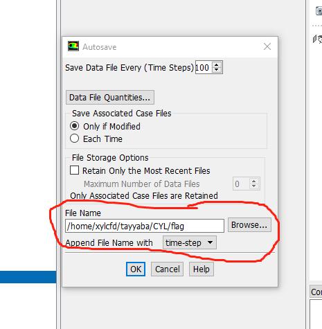

      according to this point, it is the file name and file path created by the iteration/time step index. then where can I give the path? and I did not find any file in any working directory.
      but this one is working perfectly for saving data.
      and if I try to specify a path for Cd and Cl report fils here this error pops out in fluent.
    • Amine Ben Hadj Ali
      It is just adding a running index not to mix up with appending iteration, time step of flow time.
