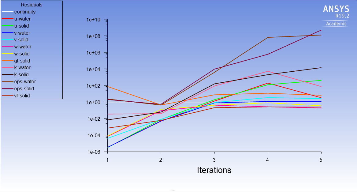

      I rewrote the code as previously, I considered Kpq as Mixture Turbulent kinetic energy but it is the momentum exchange term. The turbulent viscosity is causing the divergence. I am getting floating point error due to that.
      The residuals are given above. I am continuously getting the error :-#I have a message "Turbulent viscosity limited to viscosity ratio of 1.000000e+05 in xxx cells. How can I fix this error message in Ansys fluent? So I think the problem is with the formula. The formula given in the original paper is quite different from what is given in Ansys Theory Guide for Burns et al Model.
      By the way, I am coding according to ANSYS THEORY GUIDE.
    • DrAmine
      Why are you coding what is already available in the code? Does it run with the built-in Burns et al?
    • PrantikDas
      I am using the formula given in ANSYS THEORY GUIDE. I don't know whether it is the formula used in the built-in Burns et al Model. I am coding it so that I can compare the order of magnitude for lift, drag, and turbulent dispersion force for local cells.
    • DrAmine
      Okay I understand. What you can do is avoid this kind of unbounded division (division by alpha).
      I have the formula in the original paper and is the same as used in our codes as the author is an Ansys colleague.
      I think the vector which should be returned is relative to the primary phase like in the example of Lopez de Bertodano Case.
      But before you do that: have you verified running with the Burns. et al. without UDF?

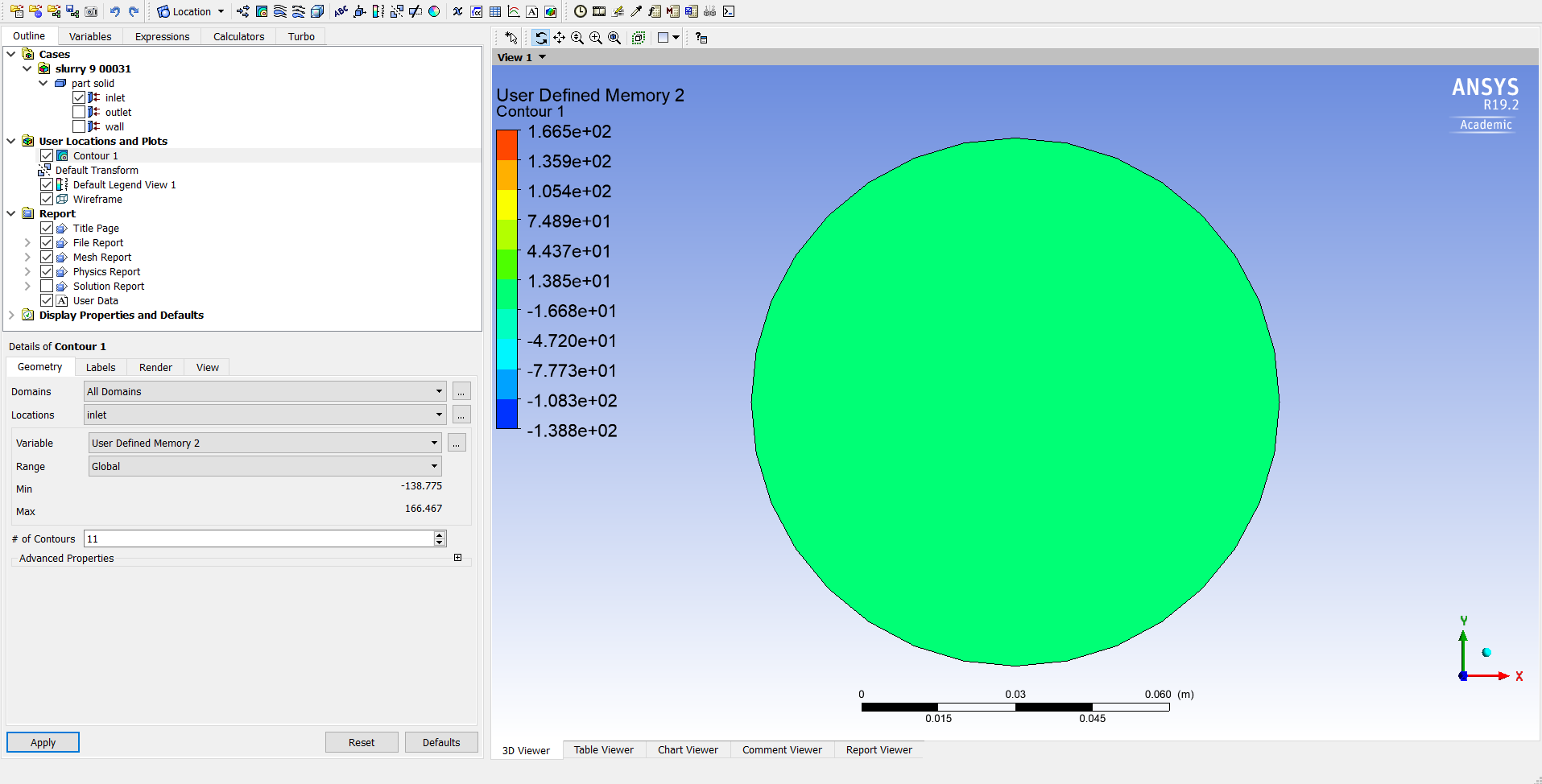

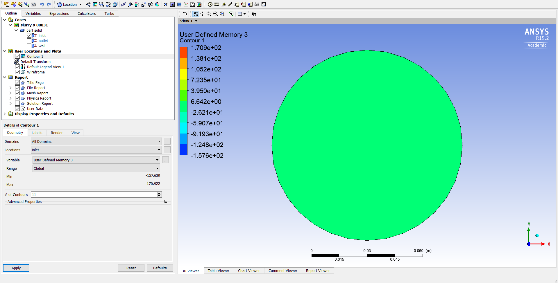

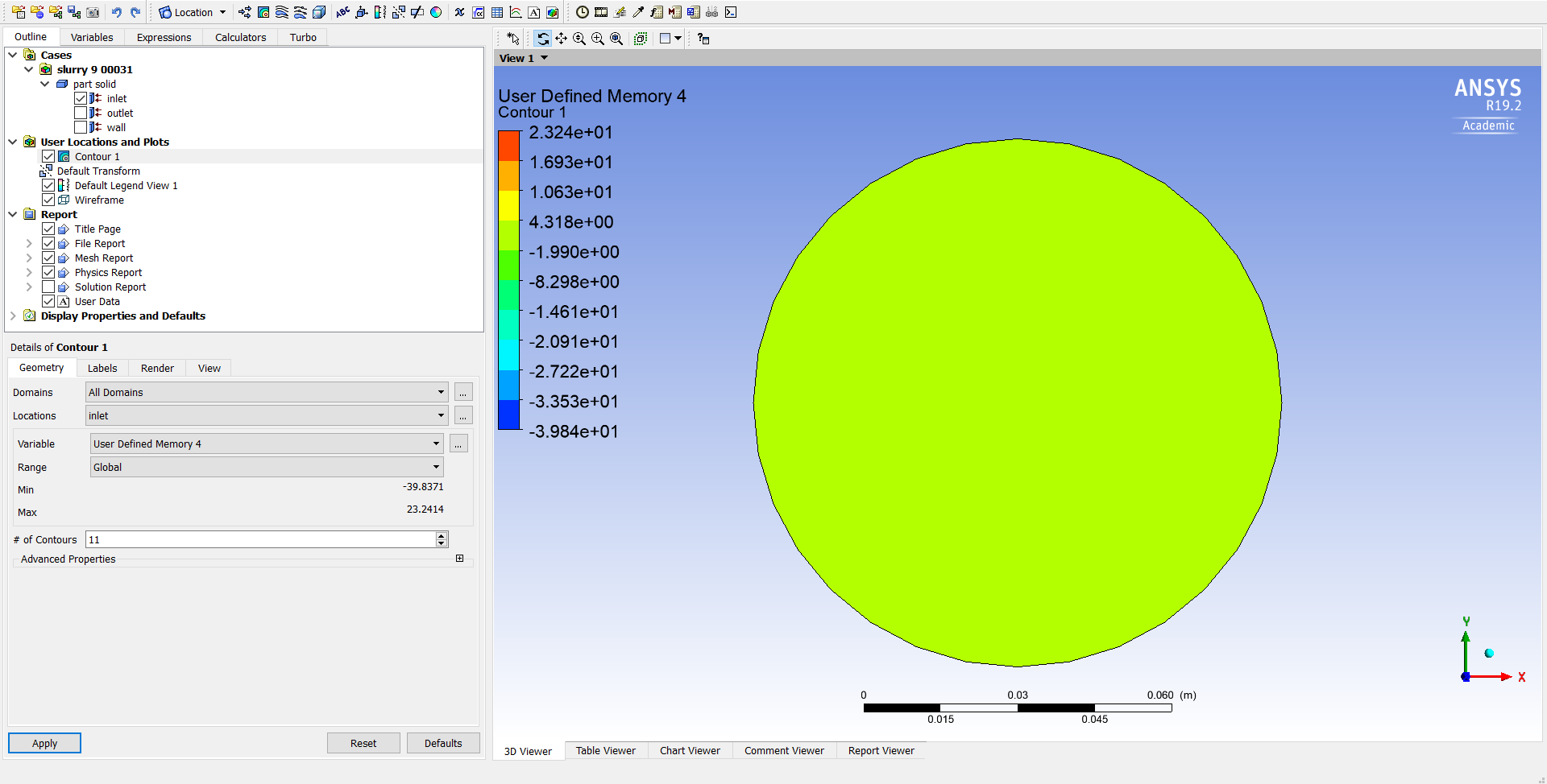

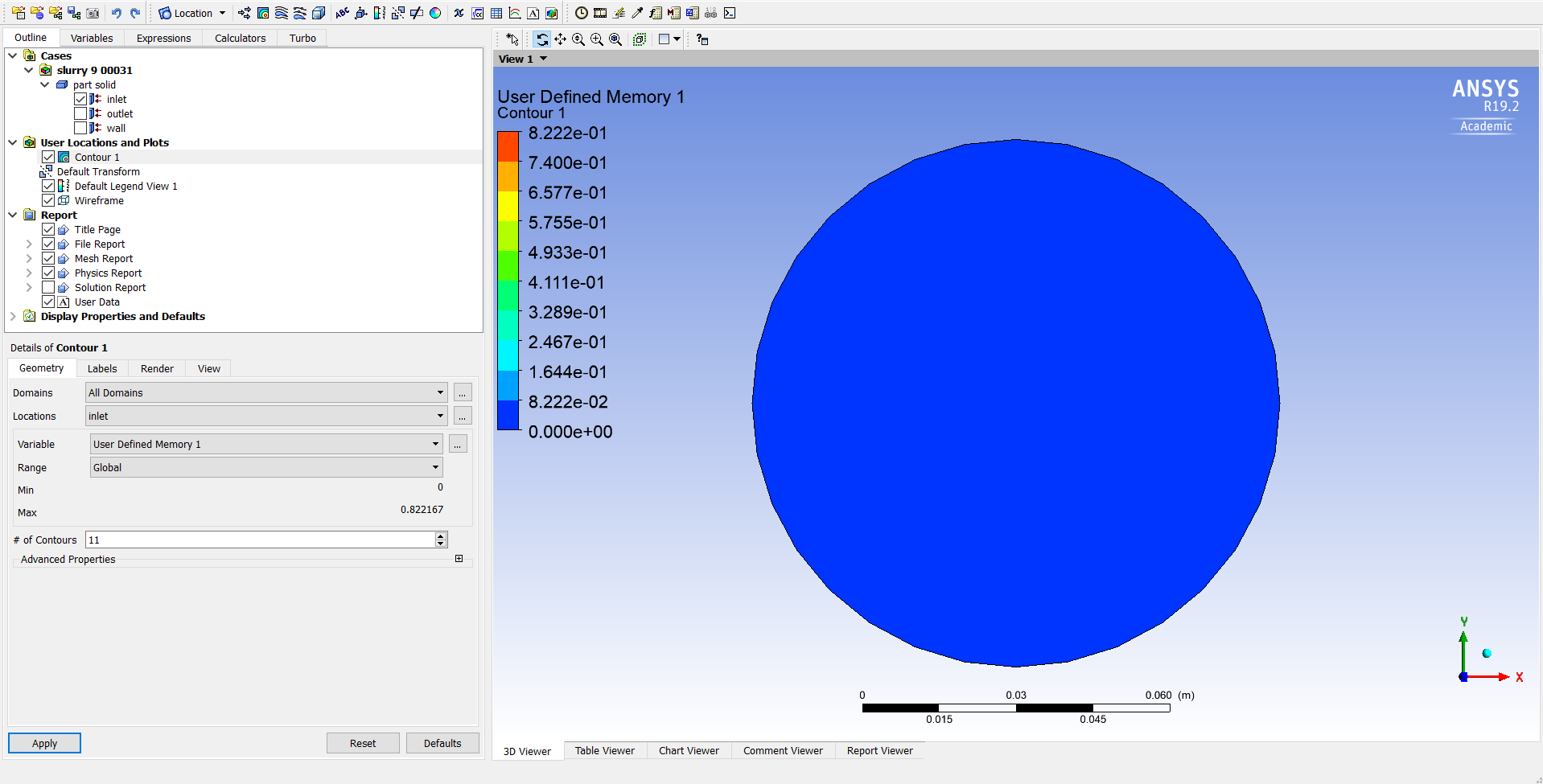

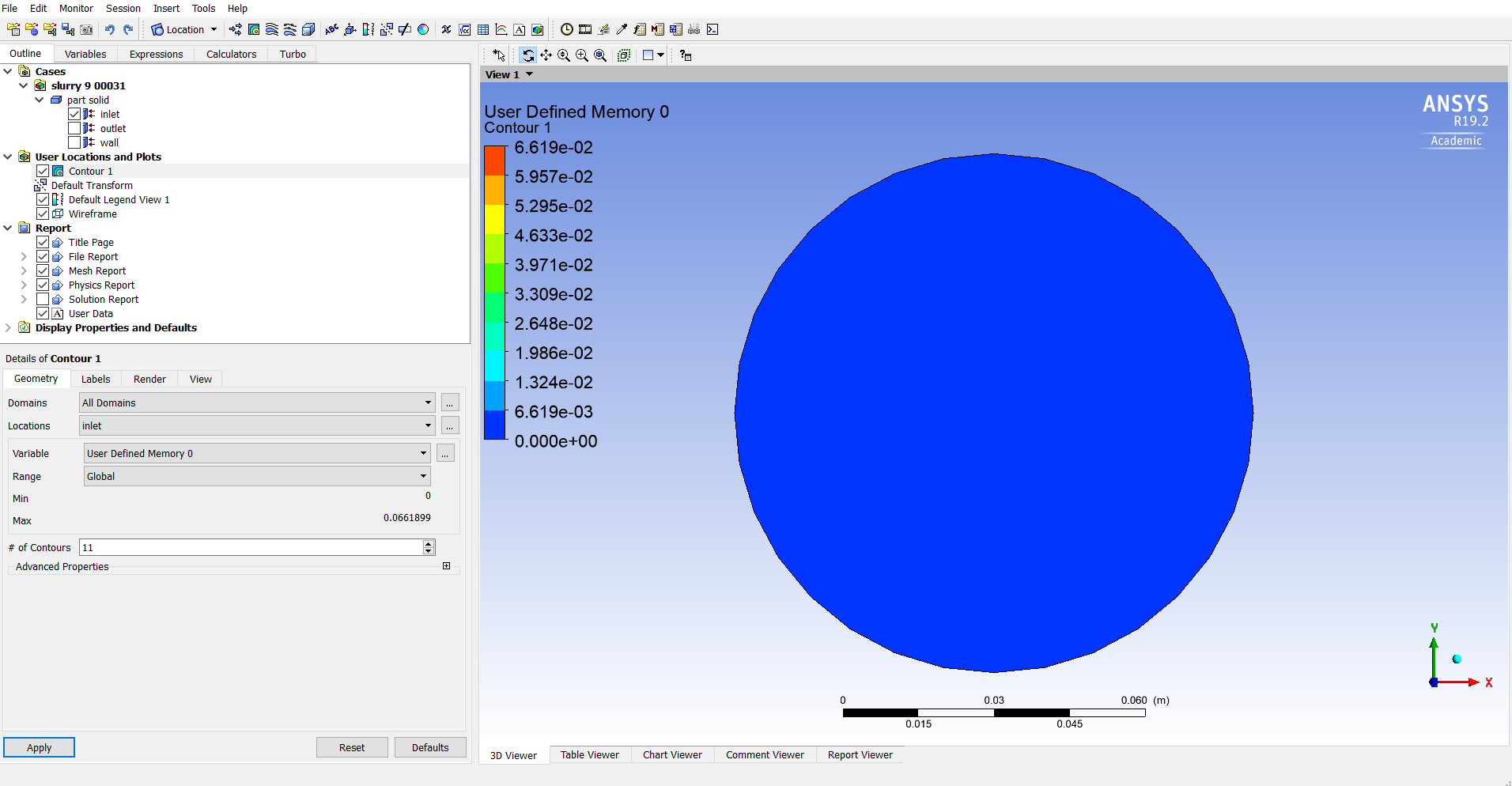

      I am getting a floating-point error at the 32nd iteration and the contours at the inlet at the 31st iteration are shown above. These are the contours of various variables at the inlet of my pipe (The variables which are stored in my UDMI)

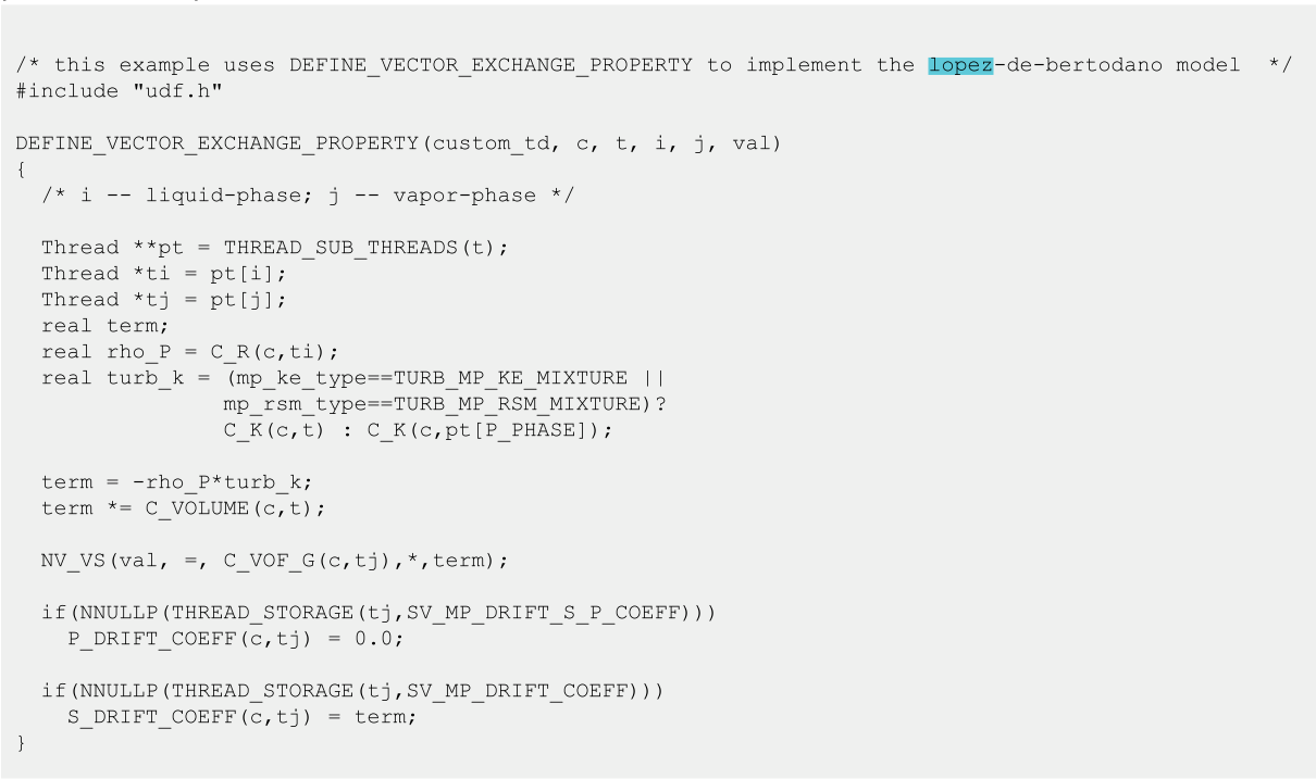

      Another question I have
      in Lopez model sample UDF given in ANSYS UDF MANUAL what does this lines mean ?
      real turb_k = (mp_ke_type==TURB_MP_KE_MIXTURE ||
      mp_rsm_type==TURB_MP_RSM_MIXTURE)?
      C_K(c,t) : C_K(c,pt[P_PHASE]);
      2.if(NNULLP(THREAD_STORAGE(tj,SV_MP_DRIFT_S_P_COEFF)))
      P_DRIFT_COEFF(c,tj) = 0.0;
      3.if(NNULLP(THREAD_STORAGE(tj,SV_MP_DRIFT_COEFF)))
      S_DRIFT_COEFF(c,tj) = term;
    • DrAmine
      The documentation goes in some aspects into what you are asking.
      1/Getting TKE using some sanity checks. C programming + some Fluent Predefined variables.
      2/The two others terms are not documented but what I can understand is that the second one requires your return value for the drift coefficient and the other ones is not required as you are not adding term into the continuity equation.
      I can double check the meaning of those terms. I will write back if I have something different to share but I am confident what I wrote is correct.

      P_DRIFT_COEFF is the coefficient of the volume fraction gradient of the primary phase (zero for Lopez et. al.) S_DRIFT_COEFF the one for dispersed volume fraction gradient.
