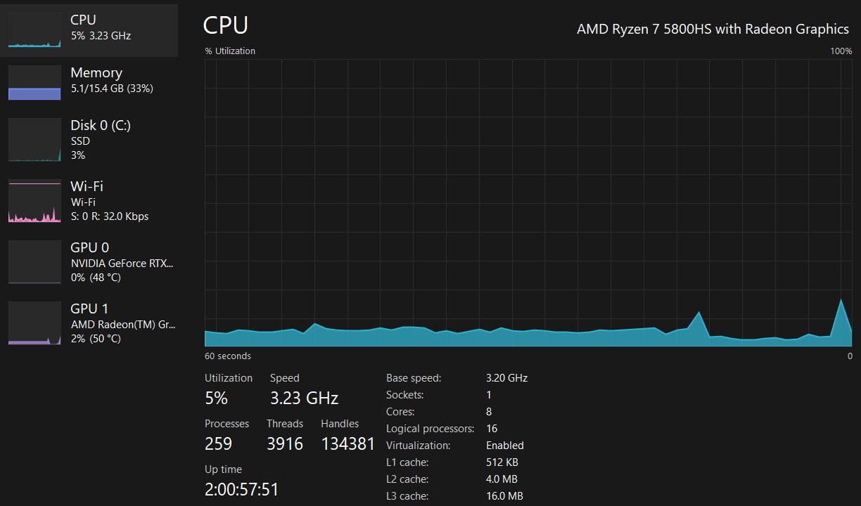

BTW, I am totally fresh to parallel computing and still confused about the relation between "compute node" and number of CPUs. Seen from Windows Task Manager (snapshot as following), my workstation has two so-called "Node" and each node has 36 CPUs. Thus I guess the "Node" here refers to the fact that my workstation has two distinct Intel Xeon CPUs, and "CPU" here actually refers to the fact that each Intel CPU has 36 threads? How could I confirm the number of compute node and its correspondences with CPUs on my workstation?Â

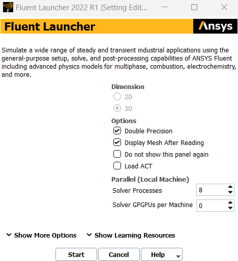

If I run 32 processes on two CPU sockets (each socket has 18 cores), what alteration in parallel settings do I need to make? I am using ANSYS FLUENT 19.0 and the following are snapshot of the launcher.Â

Those settings look fine, but I'd expect an error message of some sort if it's not pickup up the second physical processor.Â

SubscriberDear Fellows:nRegarding the discussion, I have a question. I have the same problem. Have a 16 core license of Fluent running on a 12 core processor with 24 threads. nSo, at the limit of the license, I would be using only 8 cores intead of the 12? nWhat happens if I disable the hyperthreading from the BIOS. I would use all the 12 cores and 4 would be free?nThanks in advance!n -
March 15, 2021 at 11:52 am
Rob
Forum ModeratorWith 16 parallel and 12 real cores you'd double up on 4 of the cpu cores. Turning off hyperthreading would leave the 12 physical cores and you'd run Fluent with 12 parallel. You can run all 16 but you'd lose efficiency: I occasionally launch 32 core parallel on my 4 core laptop if I don't check client support cases. n -
