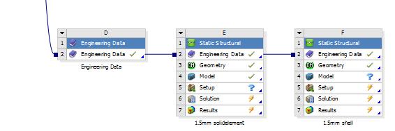

      When i finished my module and got results, I cant save the file. I dont know why.
      workbench look like as follow
      As you can see from above the hazard and question marks are there
      When I click refresh or update nothing change the question mark don't disappear and if I close the file noting saved. I've to repeat the work in model again (boundary condition, meshing......etc).
      BTW I got my results from both system, but hazard and question marks don't change to green mark
    • Sandeep Medikonda
      The next time you setup (in Mechanical), try using the 'Update Project' button in Workbench instead of running it in Mechanical.
