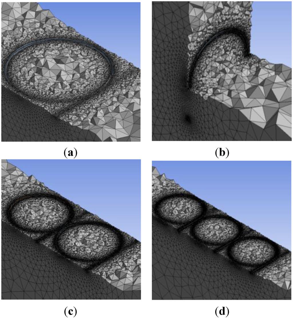

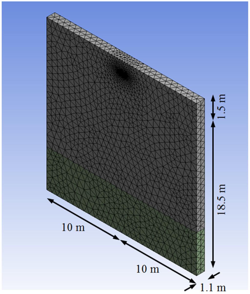

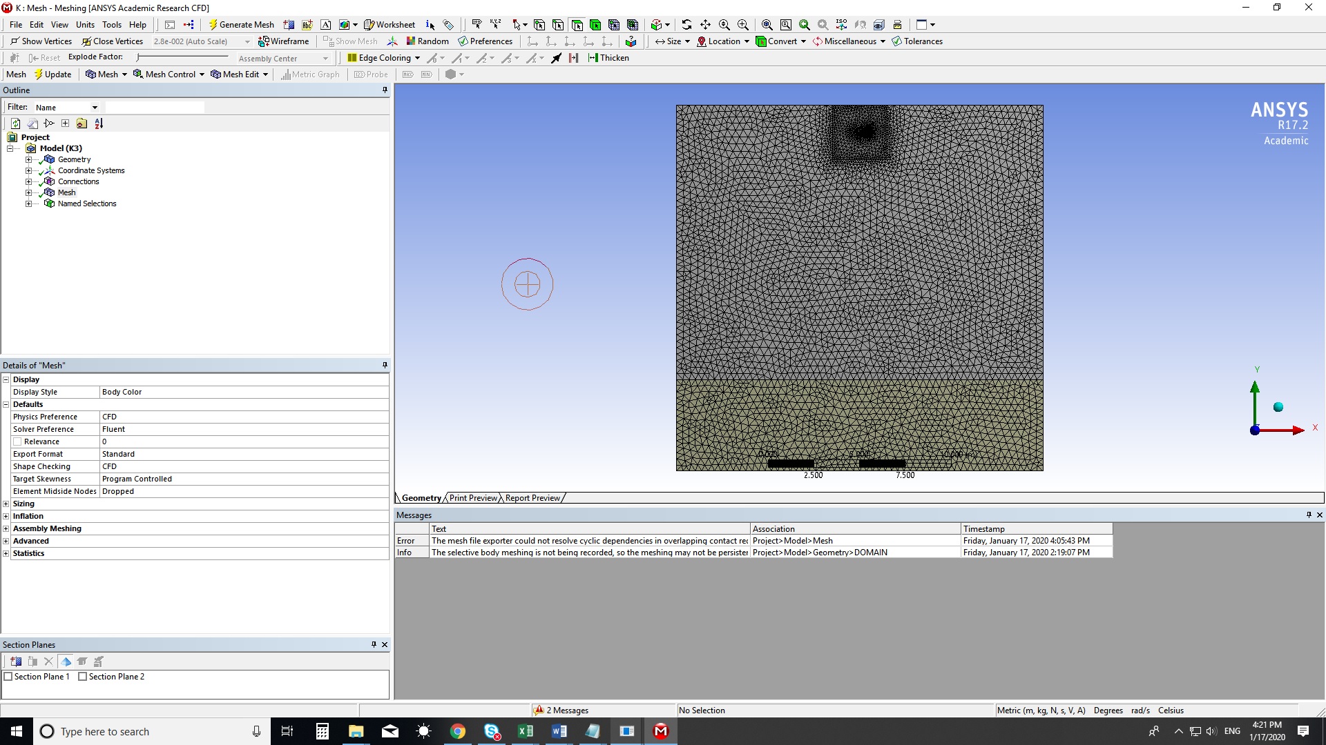

I want to simulate slinky coil ground heat exchanger by Ansys 17.2. The mesh ground is attached sample. The coil diameter is 1 m and pipe diameter is 43 mm. The mesh far from coil is robust and near coil is fine. I just want to simulate one turn due to computational limitations. However, I find mesh problem in near coil ground. I have tried body influence but it is failed. I want to get as good as attached figure.
Do you have any suggestions?

Forum ModeratorDoes the coil touch the edge of the domain?

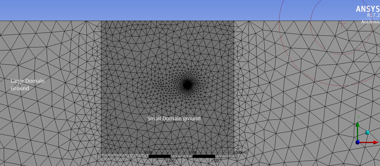

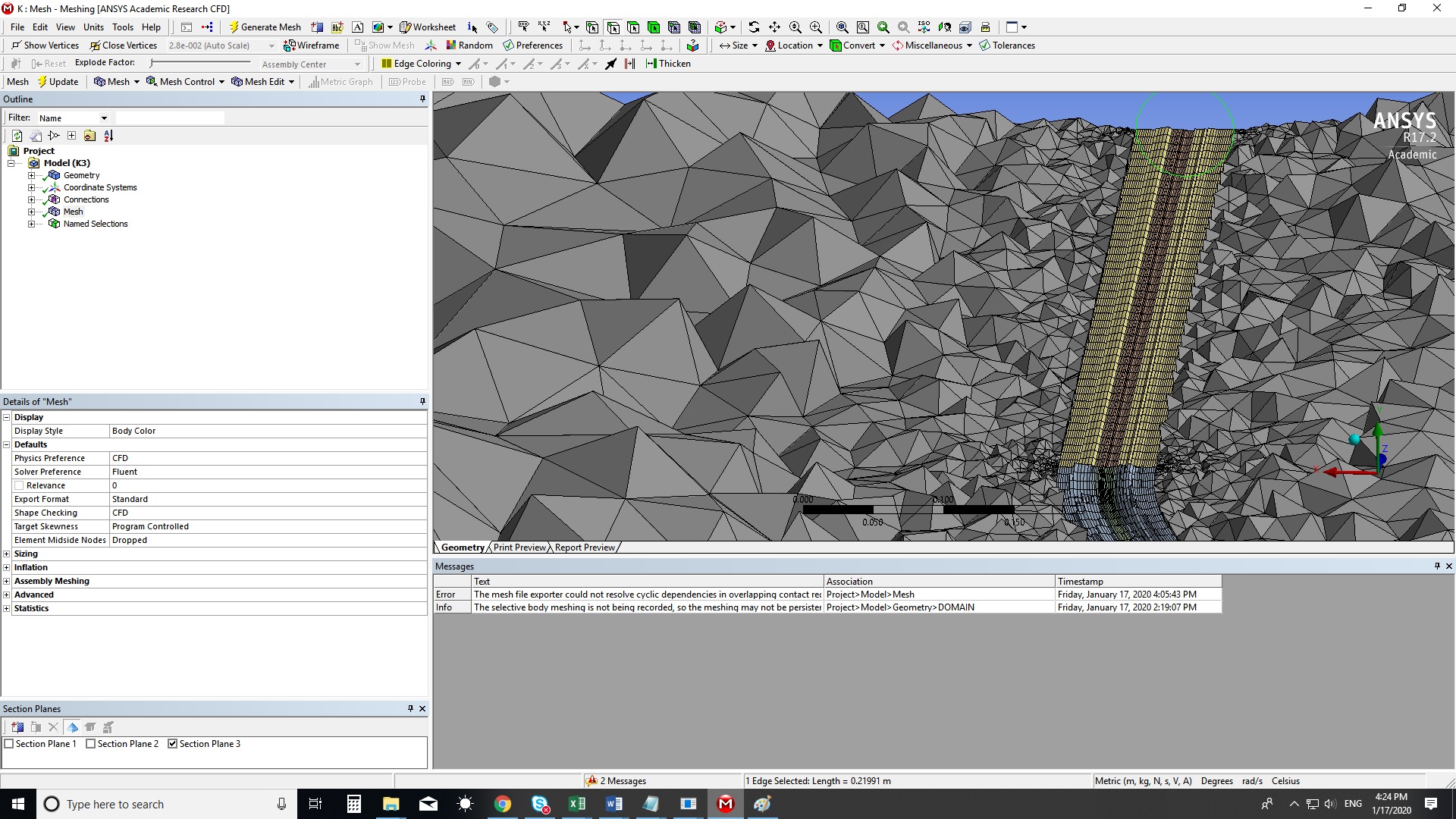

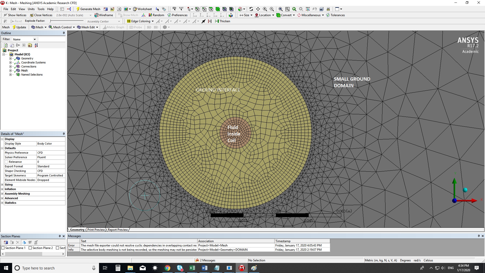

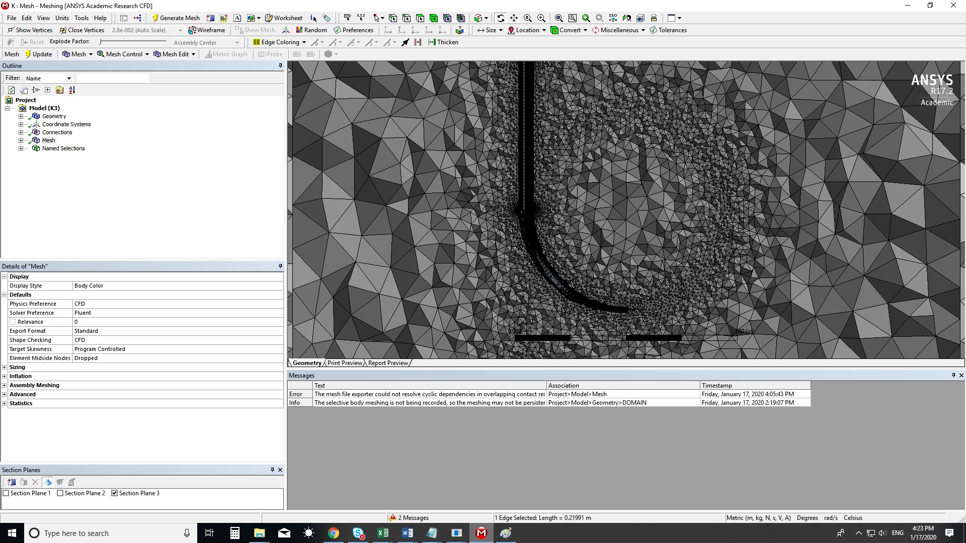

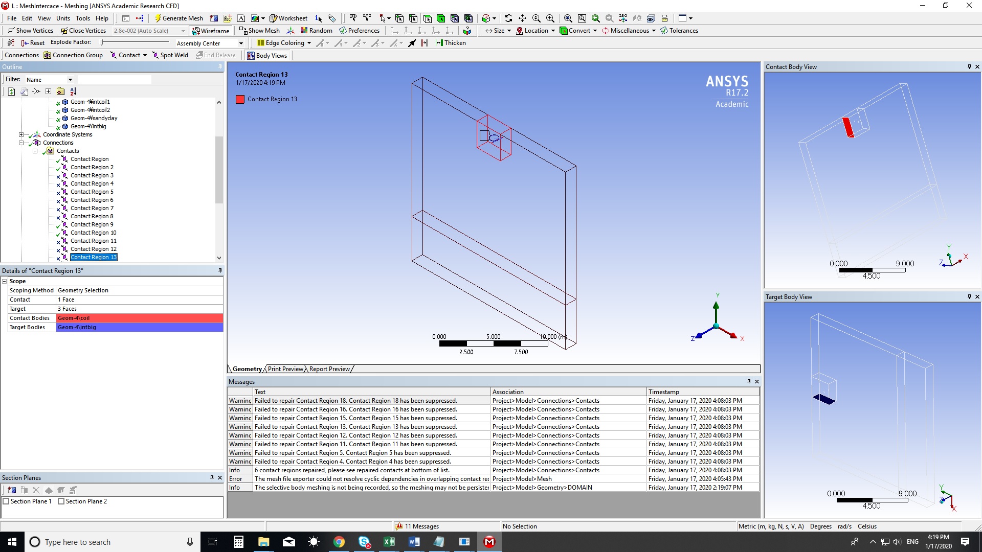

I have tried body influence it seems can not work so I divide ground into several parts as interface. Because the size of the coil is small compared to the ground. It makes me easier to mesh. However the problem is overlapping mesh. Do you have any suggestion? Thank you for your help
Regrads
January 17, 2020 at 10:56 am
Rob
Forum ModeratorCheck the contact regions carefully. I suspect you've got the ones you want and (possibly) some trying to pair faces that shouldn't contact.Â

Thank you for your reply. Well, I think I don't recognize each contact region. I will check each contact. If I find any problem, i will ask you.
