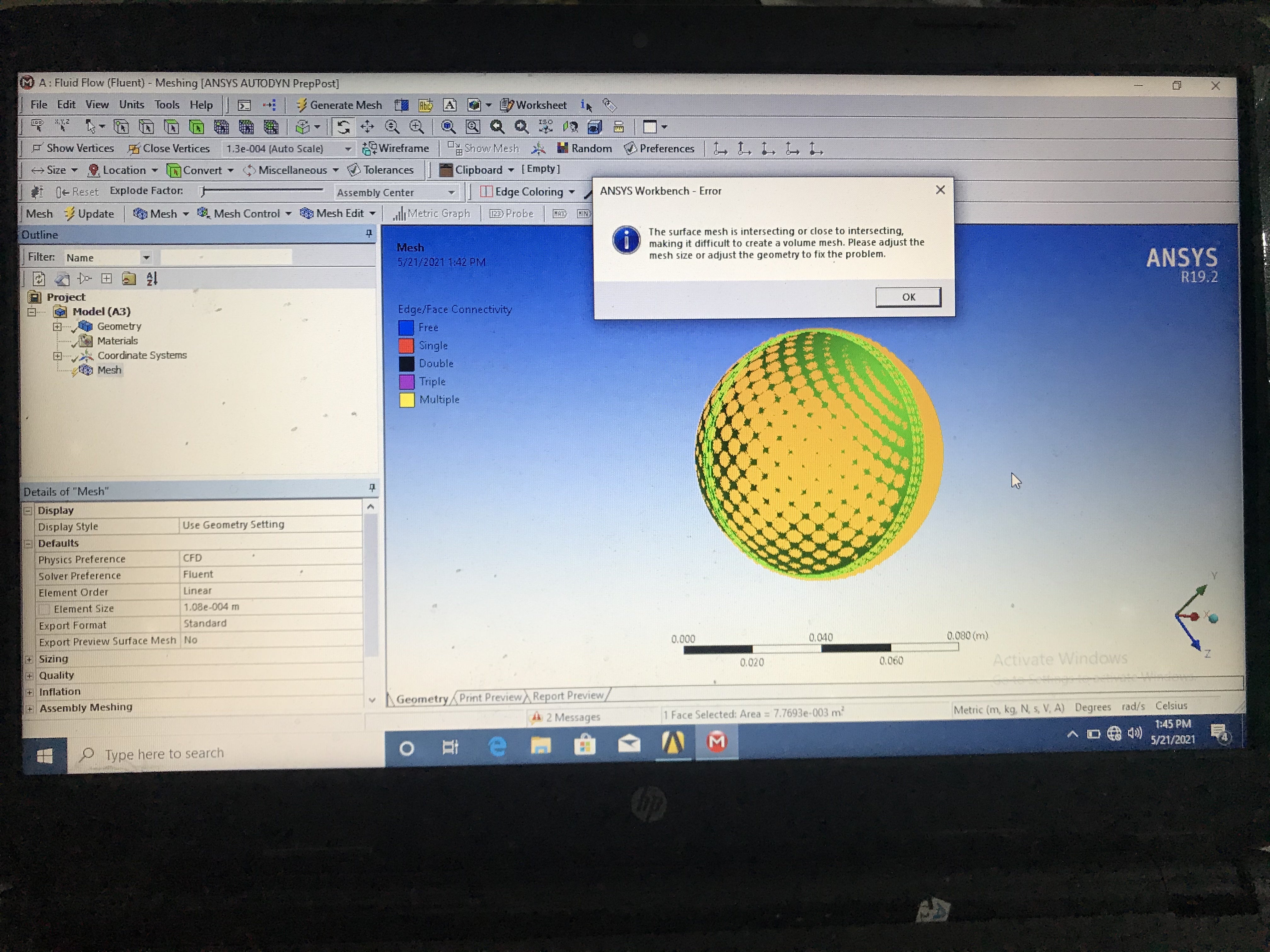

SubscriberIm doing analysis on cricket ball. I have created a box for it. Now when we go for meshing and start the meshing, after a long time the messages appeared and the meshing doesn’t go to completion.
i have changed the element size too many times but still not getting a good result,

Forum ModeratorIs the surface smooth or have you included the seam and stitching?
June 2, 2021 at 6:31 amsikanderafridi
SubscriberYes Sir, i have included the seam and stitchings.
June 2, 2021 at 10:05 amRob
Forum ModeratorHave a very careful look at the geometry. You probably have some very small details or overlaps that are causing problems. Make sure curvature & proximity size functions are on and see if that helps. Note, the mesh count may be too big for Student so you may need access to a Research licence.
June 2, 2021 at 6:40 pmsikanderafridi
SubscriberSo what i do??
give me some direction
June 3, 2021 at 11:52 amRob
Forum ModeratorHave you found region where the geometry is overlapping?
June 3, 2021 at 1:52 pmsikanderafridi
SubscriberYes, clicking in the message tab, clicking on show problematic geometry
today i tried it without seam and stitching but again it shows that error.
June 3, 2021 at 3:10 pmRob
Forum ModeratorYou have a clean spherical void?
