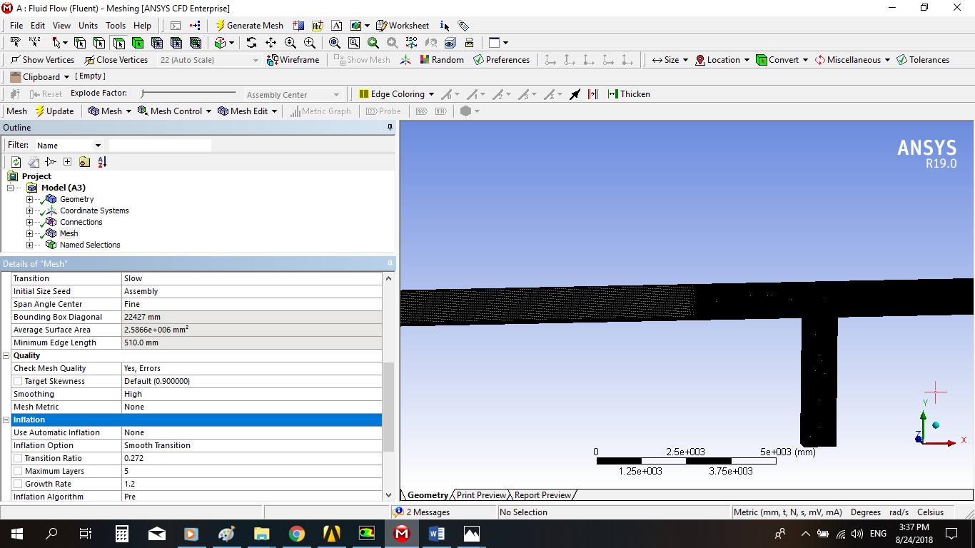

      and this is my geometry
    • Walaa

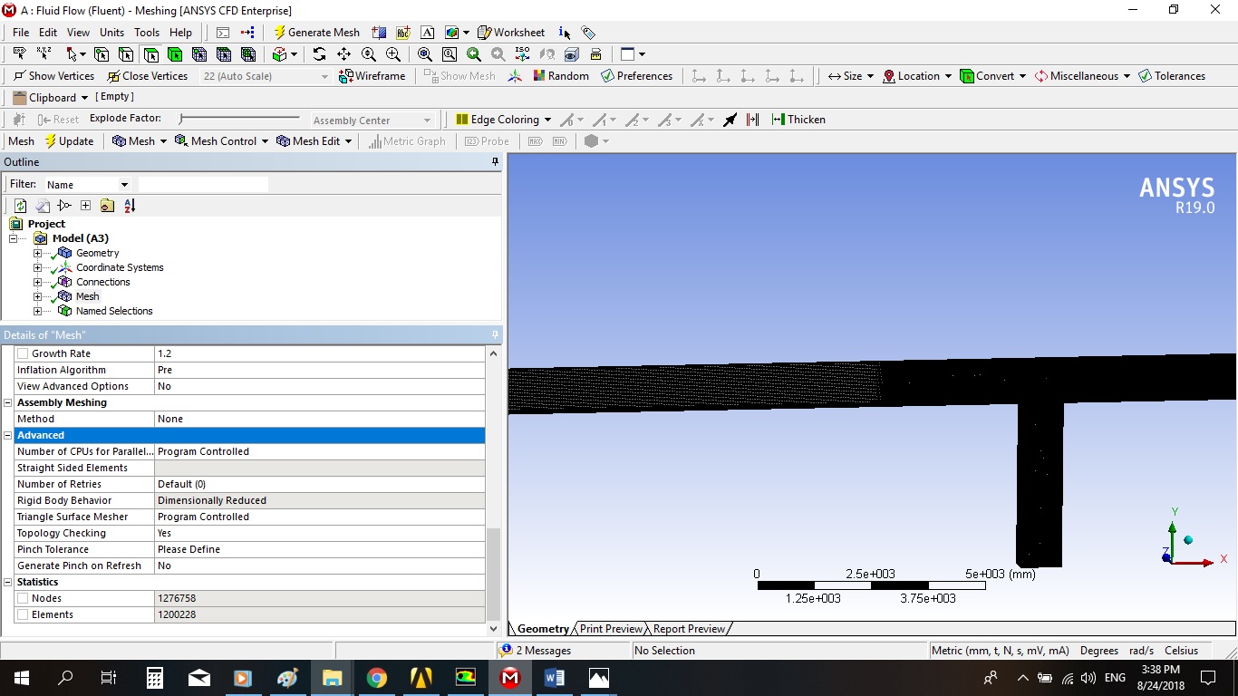

      this all my mesh details
    • Walaa
    • Walaa
