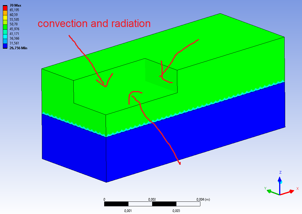

I'm struggeling with the esel command. In the simulation I create surface elements at the external nodes of an workpiece within the /prep7, then I go back to the /solu. A single frame restart analysis:

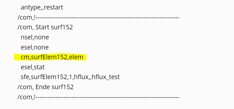

/com,!------------------------------------------------------------------------
/com, Start surf152
nsel,none
esel,none
cm,surfElem152,elem
esel,stat
sfe,surfElem152,1,hflux,,hflux_test
/com, Ende surf152

!------------------------------------------------------------------------------The output shows 12 surf152 elements are created in /prep7, but I can't select them with esel in the /solu after restart.
I don't know why

The solver output is indicating that 6720 Elements are selected, but in the /prep7 I created 12 surface elements.

Start surf152 selection for thermal load
****** STATUS OF NODES ******
NUMBER OF SELECTED NODES= 21662
NUMBER OF DEFINED NODES= 21662
MAXIMUM NODE NUMBER= 21662
****** STATUS OF ELEMENTS ******
NUMBER OF SELECTED ELEMENTS= 6720
NUMBER OF DEFINED ELEMENTS= 6720
MAXIMUM ELEMENT NUMBER= 9088
SPECIFIED SURFACE LOAD CONV FOR ALL SELECTED ELEMENTS LKEY = 1 KVAL = 2
VALUES = 25.000 25.000 25.000 25.000
*** WARNING *** CP = 1.672 TIME= 09:23:28
Some of the defined and selected elements did not require convections.
Use the SFELIST,ALL,CONV command to view a list of elements that did
have convections stored.
End surf152 selection for thermal load

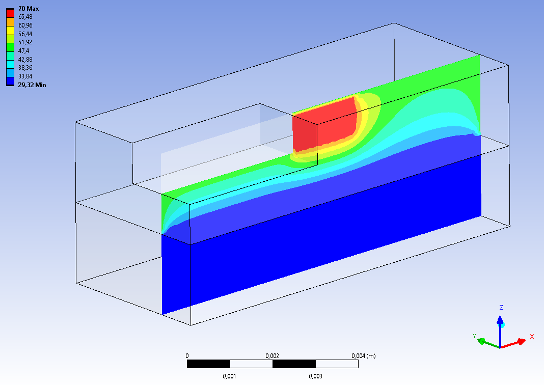

March 30, 2023 at 3:45 pm
mrife
Ansys EmployeeJohn
Check the output - the restart database is being resumed (file.rdb) after you resumed the saved database. The restart db does not contain the changes you made to the FEM.
What is the point of redoing the surface effect elements in this model? Perhaps we need to step back and assess the overall workflow.
Mike
March 31, 2023 at 3:15 pm
John Miller
SubscriberHello Mike,
I need the surface elements for an AM simulation. During the extrusion process, the elements are partially external and become after they are covered with the new layer internal. As you can see in the pictures
It’s not possible to apply radiation with GUI, because the external surface will match the finished workpiece shape after the building is done. Elements are external and become internal and so on. Application of convection via external nodes is easy, but radiation is the problem.
I thought surface elements could be the solution to this issue. Unfortunately, multi-frame restart is not possible in ansys transient thermal and a coupled thermal structural simulation is too time-consuming.
If it’s not possible to select the surf152 elements in /solu after creation in /prep7 and a single frame restart, the whole simulation is impossible.
With best regards
John
