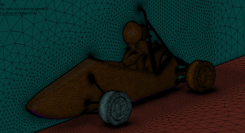

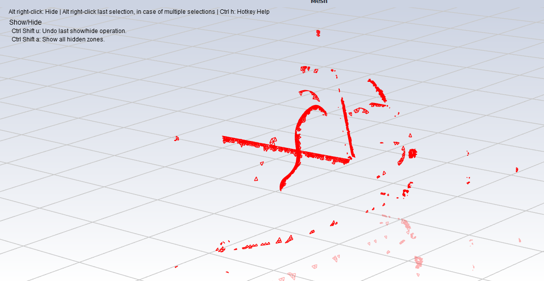

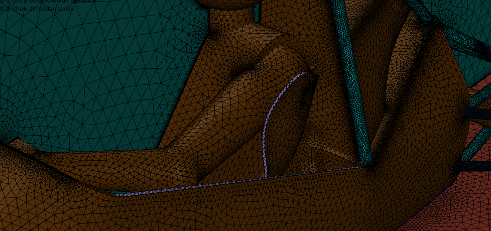

SubscriberI am trying to create a mesh of a formula student vechicle with 15 layers of inflation layers in FLUENT Meshing. Independently of the type of mesh that i am using the prisms that are created have a bad orthogonal quality - this happens only when there is a sharp angle in the geometry (~ 90 degrees) or where the mesh transitions between the regions of different first layer thicknesses. All of the zones have the same amount of layers and I am using the last ratio method. I tried meshing and then using auto node move but with no success. I am attaching the screenshot of the geometry and the bad prisms. Is there another way of fixing this other than rounding every corner i have in the model?
My surface mesh quality was perfect (skewness < 0.5). Any advice would be really appreciated!

Ansys EmployeeWhat is min orthogonal quality of your volume mesh?Â
What is surface mesh size you are using? What is first hegiht of prism?Â

SubscriberSo, after a lot of iterations of auto-node-move i managed to bring the quality up to 0.043514615. When it comes to the surface mesh size, on the problematic areas the cells have the size of around 5, but there are areas where the face size is near 3 and the problem persists. For the first cell height i have for different zones from 0.01 to 0.08.
Piotr
August 18, 2023 at 8:00 am
Keyur Kanade
Ansys EmployeeIdeally min orthogonal quality should be 0.1. But practically 0.04 can work.Â
