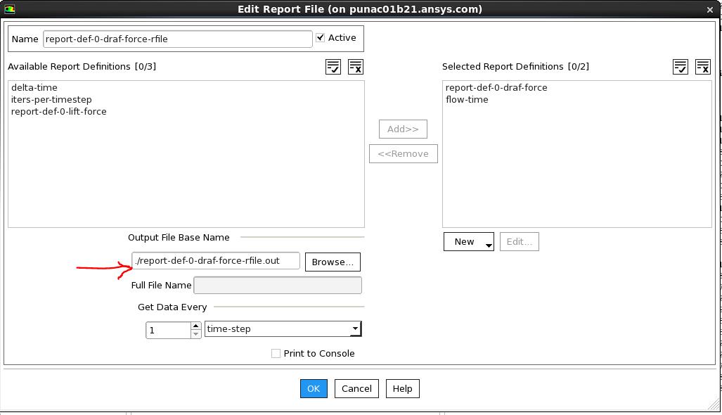

Rob
Forum ModeratorCan you check you're saving the files to the ./folder  as Fluent has a tendency to save full paths. Depending on your local machine & cluster it may be trying to save to a non-existent location. Another method is to run a short journal on the cluster once the case & data are read in to set the monitors saves.Â

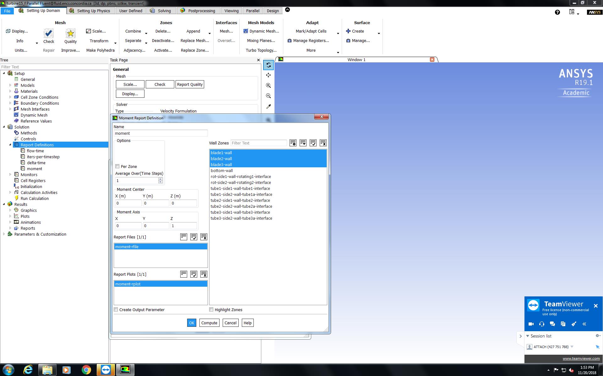

mazab17
SubscriberIn the solution section, report definition, I defined the moment at the zone that I am looking for and moment axis. In the report file and plot, I added the moment and check the print to console box. I saved the project and export the .cas and .dat files. Then I uploaded in my directory in the cluster and submitted the job. It's running but nothing printed and no files that included the moment was saved. BTW, I have the professional version that is provided by my supervisor, not the student version.Â

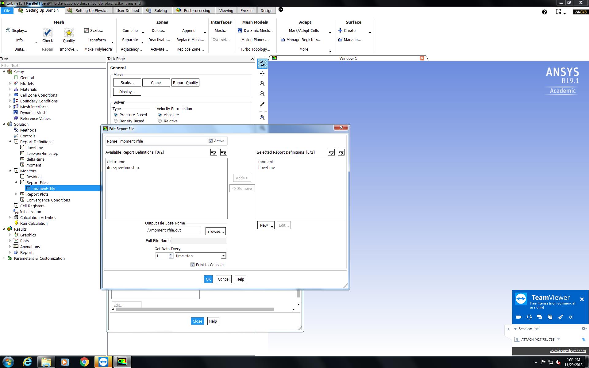

Keyur Kanade
Ansys EmployeeCan you please check Solving - Run Calculation - Advanced - Reporting interval? Set this interval to 1.Â

mazab17
SubscriberI already set up to one.Â

Amine Ben Hadj Ali
Ansys EmployeeAre you writing a transcript file or does your job scheduler (if used) writes a transcript file. Sorry I need to ask this as If you re running in batch and using print to console then either it will print everything into standard output (not really helpful on cluster) or into transcript (if set in Fluent or via Job scheduler)

Amine Ben Hadj Ali
Ansys EmployeeI can see the picture, strange!
In words: in Report Definition>Moment check if "Print to Console" is switched on.
Can you check the content of case2.dat if it does contain the required information or at least residuals?Â
100% safe: in Yjournalurna "info.jou" write at the beginning /file/start-transcript mytrans and at almost endt before exiting /file/stop-transcript

Ansys EmployeePlease post a screenshot of Moment Report Definition.Â
November 20, 2018 at 6:31 pm
Amine Ben Hadj Ali
Ansys EmployeeJust to highlight one thing: You are still using the old "Monitors" to get the moments. They would actually give you normaly what you want but I recommend using the new Report DEfinitions. So Please just create a new Report Definition>Moment then give the necessary input and do not forget to write in a file using local paths and print to console.

Amine Ben Hadj Ali
Ansys Employee1/In R19.2 there is an option to set "Print to console" under Moment Report definition.
2/Please check if you can see the moment written in the console if you are running interactively (with GUI)
