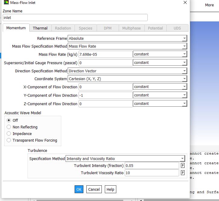

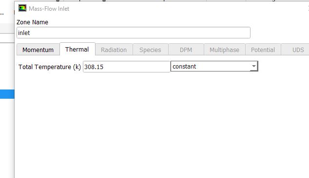

      Greetings,
      I am modelling a gas flow inside a chamber with an inlet and a outlet. I've given inlet pressure as 202650 Pascals and my inlet temperature of gas is 308.15 K. I've given the body temperature as 297.15 K in initialization window as well as patched the chamber with 101325 Pascal as shown in some random youtube tutorial video. When i run my case the pressure falls and then stays in between 200-300 Pascals although the temperature bar acts normal. Can anyone tell me where my case is going wrong, it is very urgent. Also, when i specify my mass flow rate at a certain value let's say 4L/min. The values keeps on fluctuating throughout the calculation and i desire it to stay constant throughout the calculation.

      Please add screenshots of pressure inlet bc, initialization panel, operating condition and contour plot.

      Yes sure I will attach files below.Pressure ContourBoundary ConditionBoundary Condition 1Initialization Window Operating Condition
    • Amine Ben Hadj Ali
      Which values are you now expecting to see? By the way you are not now fixing the inlet total pressure as you mentioned in your post. You are using a mass flow inlet and this would lead to a variable total pressure to reach desired input mass flow.

      Yes i told you I'm giving inlet as 4l/min, the issue is that during the calculation the mass flow rate varies a lot and is not constant at all. I've attached a file for you to see what i mean. How can i rectify this issue?
