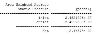

      Your pressure difference is about 1e-8 Pa according to the graph so I suspect it's not so much the panel isn't working as it's not showing that many significant figures. Can you calculate the area average pressure on each periodic surface?
    • agaddam
      I tried that way. And the result is below between 2 planes at the inlet and outlet (periodic boundaries).

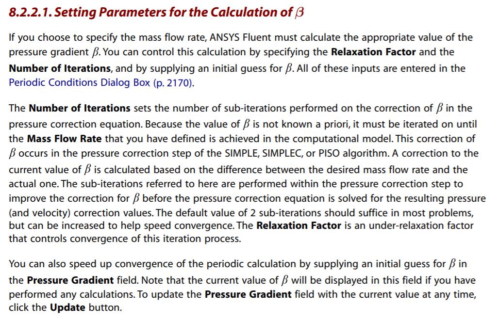

      The thing is according to the theory below, the linearly varying component of pressure drop should be being updated in the dialogue box in fluent. I although provided initial guess, there is no use.
      Increase the mass flow by about a factor of 10 and see if that helps. If it doesn't try another factor of 10. I want to see if the problem is the model or the fact the pressure drop is near enough zero.

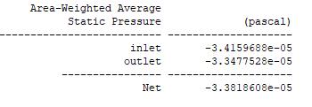

      Yes, I increased mass flow rate by 100 fold, yet, there is no change.  The pressure difference between planes is attached below. The same model previously I ran on Ansys 15/16, it worked pretty fine. Since I changed university, I don't have access to old version of fluent now.
