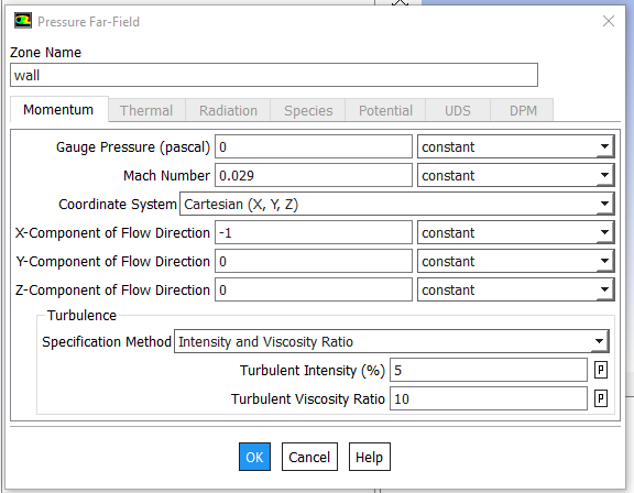

SubscriberI am simulating the flow across a wind surfing sail and decided to use pressure farfield for the outer walls, however I am getting error:
Error at Node 0: Mach number at Pressure Far-Field boundary should not be set to zero.
Check the specified mach number on Pressure Far-Field boundary conditions for thread 1.
You may want to consider specifying small mach number value instead of zero.
with defined mach number. I have set up the mesh with very far walls from the sail itself, so it should be fine to define the walls as far field. I would like to know how am I able to solve this. Thanks a lot!

SubscriberFor the inlet, yes I chose velocity inlet. Since I obtain very bad results using basic wall conditions for the surrounding walls of a c-type mesh, I read about this pressure far field and now I wanna use it to see if it works better
May 23, 2021 at 4:54 amTegdlemat
SubscriberI just read the manual, it requires a constant fluid density, which I have defined it already. However, I have modified the viscosity to match my experiment Reynolds Number setup.
May 24, 2021 at 7:43 amRob
Forum ModeratorFar field can't have a fixed density as that means the speed of sound isn't defined: hence the error.
May 24, 2021 at 9:19 amTegdlemat
SubscriberUnderstood. So there should be an option to choose a non-constant density at the material section or the definition of the far field or both? Thanks Rob!
May 24, 2021 at 10:35 amRob
Forum ModeratorIt's a material property. You'll need ideal gas so may need to readjust the viscosity to match the Reynolds Number.
