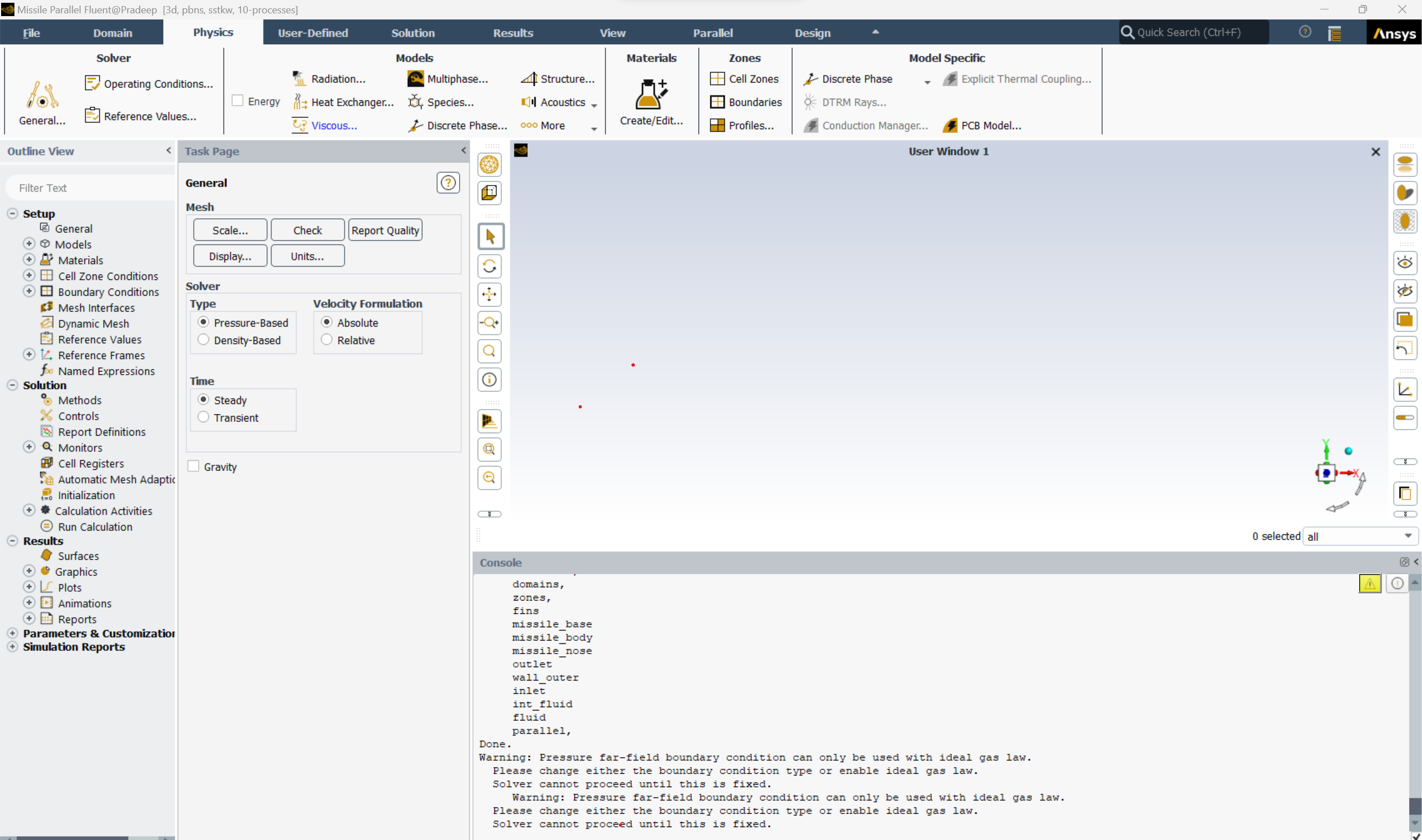

      i created mesh in iCM CFD while exporting mesh for fluent i have mentioned boundry condition as pressure far field but while i read mesh in fluent i getting this error.
      (Warning: Pressure far-field boundary condition can only be used with ideal gas law.
      Please change either the boundary condition type or enable ideal gas law.
      Solver cannot proceed until this is fixed.
      Solver cannot proceed until this is fixed.)
      You either need to set ideal gas for the material density or change the boundary type to something else.
