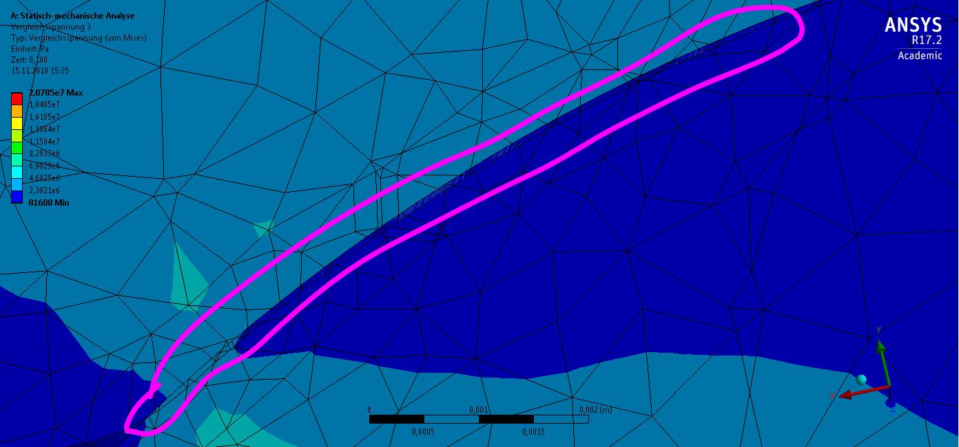

      I am currently struggeling with a static mechanical analysis with ANSYS WORKBENCH 17.2. I am using a ball joint as a part of a hip implant. In the picture you can see the socket of the joint with an area that is marked red.
      contact zone at the inner edge of the socket
      This area has the highest local pressure. I assume that the socket transfers its force to the ball through the edge instead of the transfering it through the areal contact. How do I avoid the local pressure maximum being in the edge of the socket?

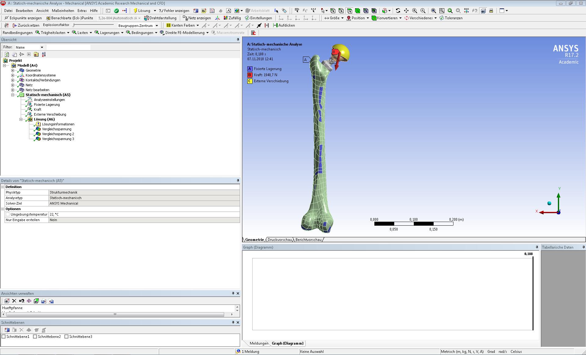

      Is use four parts: a femoral bone, the shaft of a hip implant and a ball + socket for the ball joint.
      The bone is fiexed at specific points. The shaft of the implant is connected to the bone and the ball. The contact between the ball and the socket has a friction coefficient of 0.11. The outer plane of the socket has a force and an external displacement with degrees of freedom set to "0" for rotation and "free" for translation, sothat the socket won't drift of the ball. the ball and the inner area of the socket have the same radius.
      boundary conditions
      I appreciate every help I can get here.

      The contact tool in the solution gave me quite a similiar pressure distribution - highest pressure is near the inner edge of the socket.
      contact tool

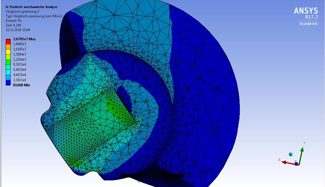

      Also, if I cut the two bodys, you can see, that the equivalent von mises stresses seem to go through the edge and not through the whole surface.
      equivalent stress (von mises)
      Also the bodies penetrate. not sure if that is because of the contact stiffness i used. (quite hard to see, but the picture quality reduces a lot when I upload a picture)

      I also tried to use two different diameters for the two bodies (difference of 2mm) and then I made them touch in one point. Right now it does not seem too bad, but I remember trying that out before and at some point I got a bunch of errors when I tried to use a finer mesh. That's how it looks like (again high stresses in near the edge although there is a gap)
      mises stress
