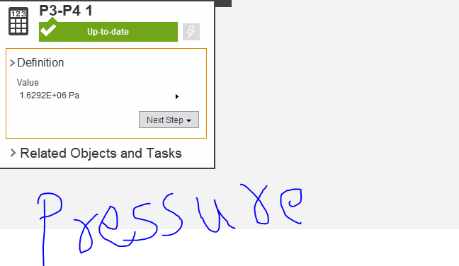

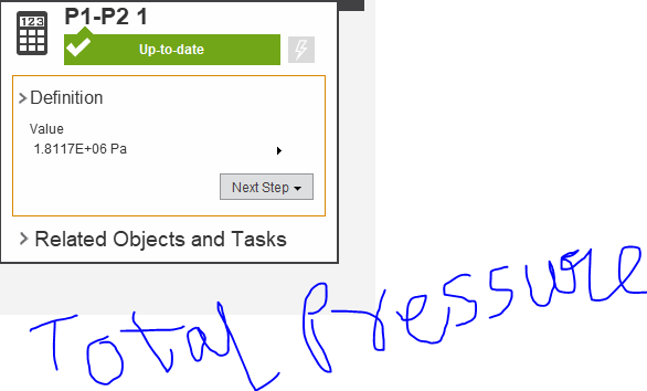

Subscriberwhat is the difference between pressure,total pressure, and absolute pressure in ansys aim
August 13, 2020 at 1:06 pm
soudarshinivalve

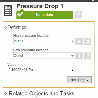

Subscriberi want to find pressure drop for valve what can i chose in results (pressure or total pressure or pressure drop). i run the simulation and i attached my results for your reference. three results are different can you explain the use of pressure , total pressure , pressure drop and which one is useful for me .Â

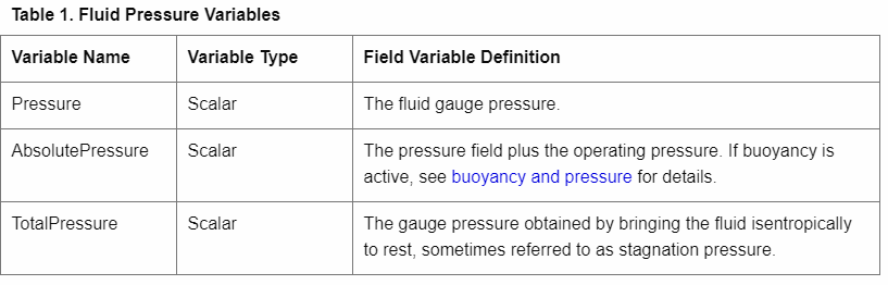

Forum ModeratorHello V Sridharan
You can clearly understand the difference between Pressure, Total Pressure and Absolute Pressure from this page in the AIM Documentations.
I would recommend looking into this page as well.
I hope this answers your query.
August 14, 2020 at 4:12 am
soudarshinivalve
SubscriberSubashni i did not have ansys customer portal login so can you please explain it in another way
