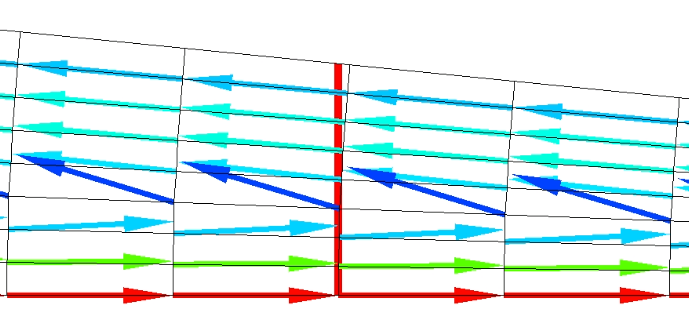

I am working on a 2D fixed-incline slider bearing model in which the bottom plate is parallel to the x-axis and moving, while the top plate is at a decline and stationary. I am able to successfully complete the simulation in Fluent but am having trouble postprocessing the results. Below is an image of the velocity vector plot:

SubscriberMy apologies, I probably should have been more specific in my question and showed that I already knew how to plot the curve in Fluent as well! I was more wondering if I could get that data in a table or a .CSV file that points out v vs y, so I can manipulate that data, such as superimposing it with other data from simulations with different parameters, plotting a regression, or taking the area under the curve.
In Fluent, while I can plot the curve out, I am not sure how to further manipulate it
December 22, 2021 at 4:21 pmRob
Forum ModeratorLook in the xy plot panel, there's a "write to file" option.
December 22, 2021 at 4:55 pmhenrysoewardiman2024
SubscriberPerfect! That worked for me! Thank you for your help!
