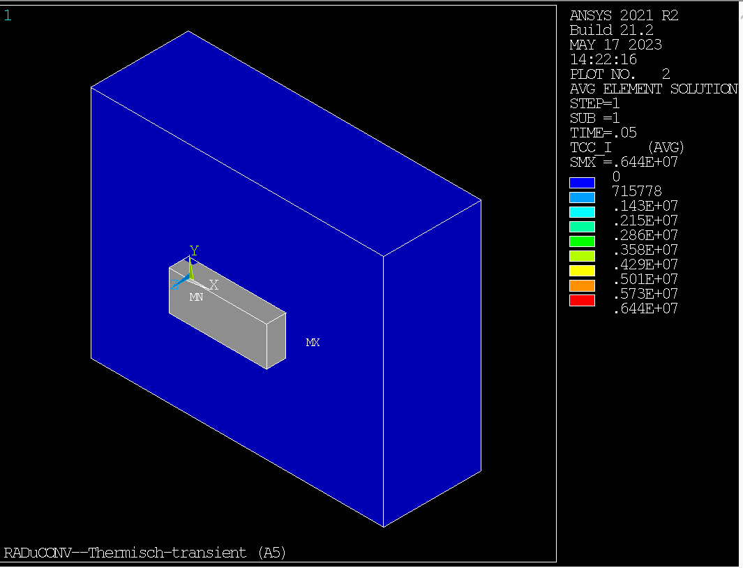

I’m working on an FDM AM simulation and got some troubles with the postprocessing.
The simulation with ekill and alive is working just fine. I’m trying to plot the thermal flux at the contact surface and the thermal contact conductance via APDL snippet:

ples,cont,flux ! plot heat flux through contact elements
etable,tcc_i,nmisc,94
plet,tcc_i,1
allsel
! plot 1 = thermal flux at the contact surface
! plot 2 = applied thermal contact conductanceThe problem is that the deactivated elements are covering the print bed contact with the extruded material. In the picture, you can see the print bed (big cuboid) and the extruded material (small cuboid). Is there a way to fade out the extruded part to reveal the contact area?
With best regards
John M.
May 22, 2023 at 12:27 pm
Chandra Sekaran
Ansys EmployeeMay be use /trlcy,cm,name,0.7 to get the elements you do not care about to show with translucency? You can also unselect the elements.

SubscriberHello Chandra,
thank you for your helpfull answer.
When I apply the changes the plot isn’t still what I indended.
Here is my applied script:

! plot 2 = applied thermal contact conductanceThe plots are looking this way:
The solve out file shows this:

I’m only interested in the display of the contact 173 elements and the heat flux through these elements. But I can’t plot it this way. The grey part named “path” should be transparent but it’s not. The underlying “bed” and “bed2″ should be not transparent, this is right in the second plot.
issue is solved.
Everthing is working just fine.
