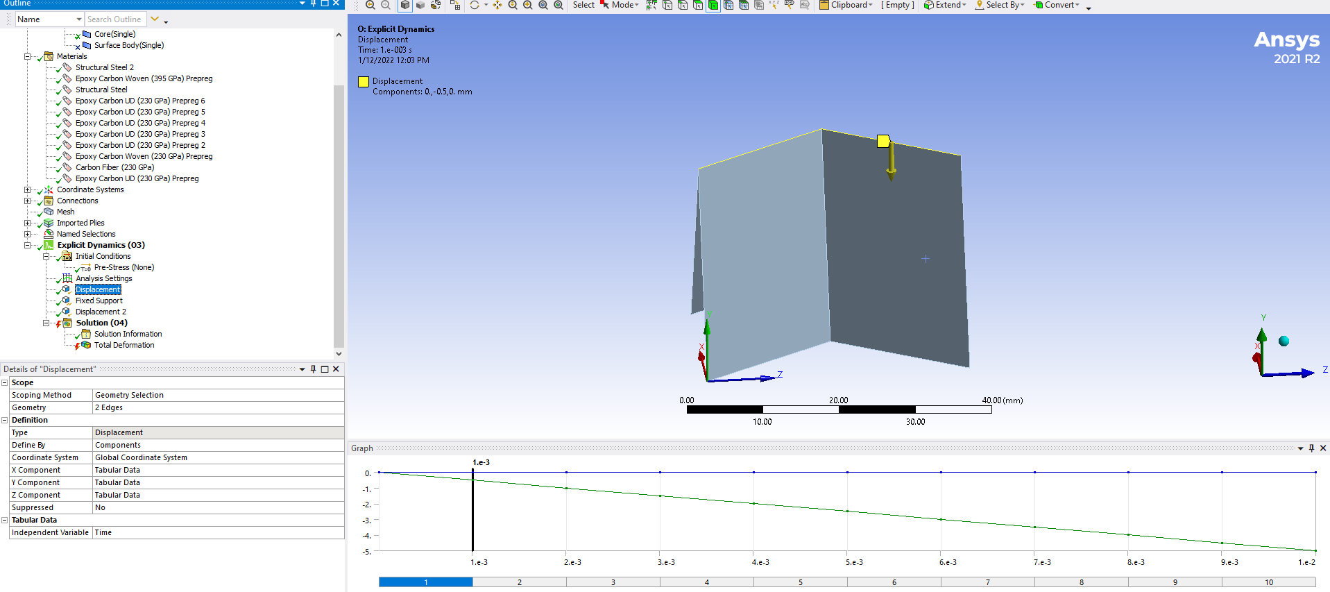

SubscriberI am trying to apply a displacement to the top of my foldcore model, as shown in the picture below, however, as I do so and run the simulation I get an error that says, "An error occurred when the post processor attempted to load a specific result. Please review all messages." As I go look at this error it tells me that there needs to be a "post processing required" What is post processing and how do I fix this.
The foldcore model is taken from ACP pre with carbon fiber as the material

Ansys EmployeeThe Solution Information under Solution in Tree Outline has the check mark, which indicates that the simulation has been done successfully.
You need to look at the Total Deformation to make sure the Display Time is set to Final. If not, enter 0 on Display Time to reset it to Final. Then you can right click Solution to evaluate the results.
