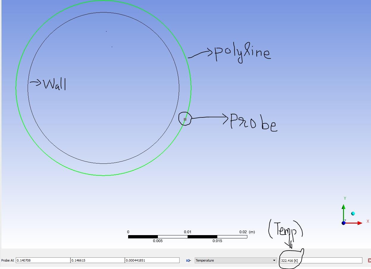

But i have plotted the chart with temperature vs the curve length of polyline. I have attached pictures below.
Here the chart was plotted on temperature vs curve length of polyline. In the graph the maximum temperature shown is below 314k. but when i used the probe tool to find the temperature at a point on the polyline i got reading 322k. This value is not even shown int the chart. Is my method correct? I was thinking about converting the curve length to 360 degree.
Thank you
Edits: When i plot chart AT the cylinder wall (not at a small radial distance) i got the same curve. So  the poly-line circle i created is giving me same result as that of the wall surface.

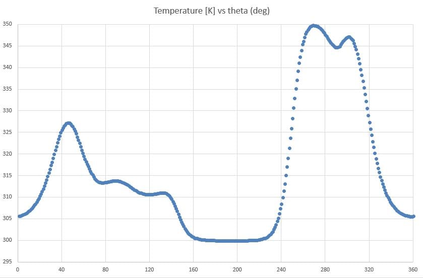

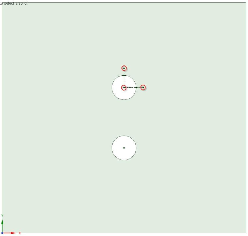

raul.raghav
SubscriberAttached are the session files which will help you create 361 points around the top cylinder center. Another session file will export the temperature data from each of the 361Â points to the Table. You can copy and paste the tabular data into excel or other graphing software to get then plot of Temperature vs theta as shown below. See the attached pictures for reference as to how to edit the session files. The session files can be edited using notepad++ or notepad. If you can't see the option of "Play Session" in CFD-Post, open CFD-Post as a standalone and not from the workbench.
Let us know if you have further trouble understanding any of this.

SubscriberSession files in CFD-Post are simple to create and they can modified according to your needs. Refer:
As a simple example, say you want to create 100 XY planes along the length of a tube (i.e., along the Z-axis). Creating one XY plane is easy, however, 100 planes is not an easy task, specifically if you want to extract information out of all the generated planes. To simplify this process, you record and save a session file by creating one XY plane. Once the first plane is created, you stop the session file. At this point, you can edit the session file with notepad++ or notepad and add a "for loop" to create 100 planes. You can be really creative about editing the session file and actually achieve a lot of things using this feature.
In your case since, you already have the two session files: (i) to create 361 points in a circular pattern around the top cylinder, and (ii) to extract data out of the 361 points and tabulate it. All you got to do is to edit the session files by changing the "x" and "y" coordinate points for the top cylinder. If you have to create points around the bottom cylinder, change the "xOrigin" and "yOrigin" in the session files as well. The basis for first session file was to create 361 points in a circular pattern centered around the (xOrigin, yOrigin) points. The second session file was straightforward extracting data from the generated points.
