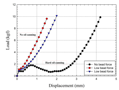

      I want to plot Load-Stroke Graph in LS-Dyna.
      In paper "Development of oil canning index model for sheet metal forming products with large curvature",
      Author drawed the Load-Displacement Graph to analyze "oil-canning" effect.
      I tried to find out "Force" or "Load" Load in Fringe But Failed and only many types of "stress" were exsists.
      So, Is there any way that i can plot "force" in LS-Dyna?
      Or, Just theoriticaly multiply the "stress" and "area of single mesh" and use this as a Force?
