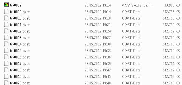

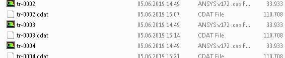

My question is easy: Do I need to save every case-file? I mean can I disable Write Case File if I want to load every timestep in CFD-Post after simulation with Fluent? It would be advantageous using less storage space.
In my case, I have already tried both but one time it worked with loading only the last *.cdat-file without the *.cas-files (every timestep was after this automatically loaded, see picture 1) and on another case, I needed every each *.cas-file in the same folder (see picture 2). Otherwise, if I loaded the last *.cdat-file only the last timestep was opening.Â

1)
2)
