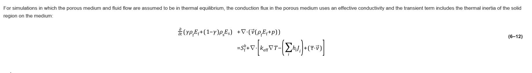

In section 6.2.3.6 in the Fluent User's Guide (Effect of Porosity on Transient Scalar Equations), it says that fluent accounts for the porosity by modifying the time derivative term to include the porosity.Â
Equation 7-1 in the Fluent Theory guide is the species transport equation. From what I understand, Fluent is not taking the porosity into account in this equation.
I have included snips of these sections at the end of this post for reference.
My question: How is equation 7-1 modified to account for porosity? Does Fluent include gamma in every term, just the time-derivative term, or only some of the terms? I have included two of these options below:
Thanks!
September 10, 2019 at 5:02 am
DrAmine
Ansys EmployeeUse physical velocity formulation and the blockage effect on convective field and on diffusion fluxes is taken into account. That is Option 2. -
