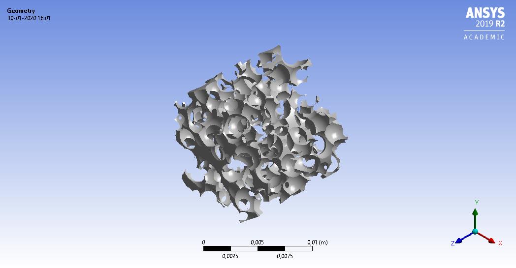

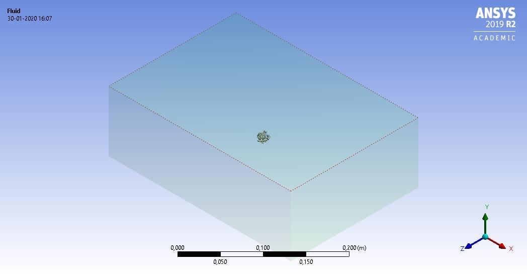

      Hi, i'm Nicolás. I have tried to simulate a heat sink made with metal foam on fluent. The image is the RVE i will use to simplify the further calculations. ANSYS is able to generate a mesh succesfully, the problem is the quality of it, in consecuence, the further calculations have unsuccesful. The first image shows the foam alone, the other shows the foam and the fluid domain. My question is, is there a way to improve the mesh quality in such a complex geometry? or should i just try to figure it out messing around with the fluent module settings?

      If you build a model like that most of the fluid will go around the foam.  Mesh quality will be a function of cell size and geometry. If you have very sharp angles you may struggle: the wrapper may help.

      Hi! i have tried to use the "wrapped" on meshing module of workbench but i couldn't find it anywhere. where can i find it ? i'm using a Java script for the geometry, then i create a fluid domain around the scripted body on DesignModeler,then i use the workbench meshing module.

      The Wrapper is in Fluent Meshing.  Try assembly meshing in Workbench, I'd stick with tets given the shapes. That may solve the geometry problem but you may either need a very fine mesh and/or get skew cells.
