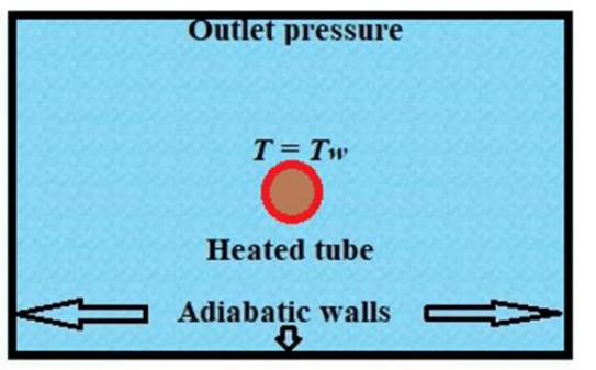

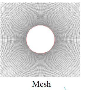

Please see below picture . There is a tank and filled with water. Inside tankt three is a heated to to boil water inside tank .
Water inside tank is 373.15 K and boiling will be sart at 373.15 K as well.
Tube Wall temperature is 379.15 K (Super ehat is 6K)
Initially: Water(primary) volume fraction is 1 - Vapur(secondary) volume fraction is 0
Moel : Euler - RPI boiling

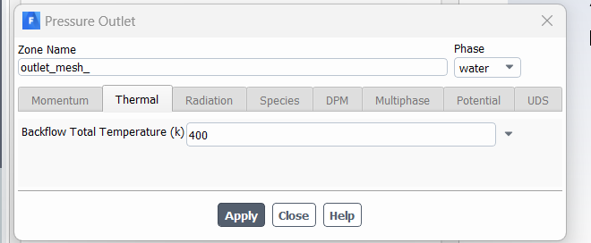

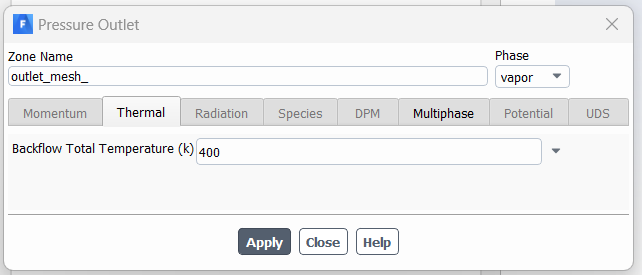

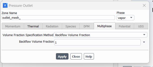

Could you pelase specfy how to set outlet pressure settings? Backflow temperature of water and backflow temperature of vapur ?

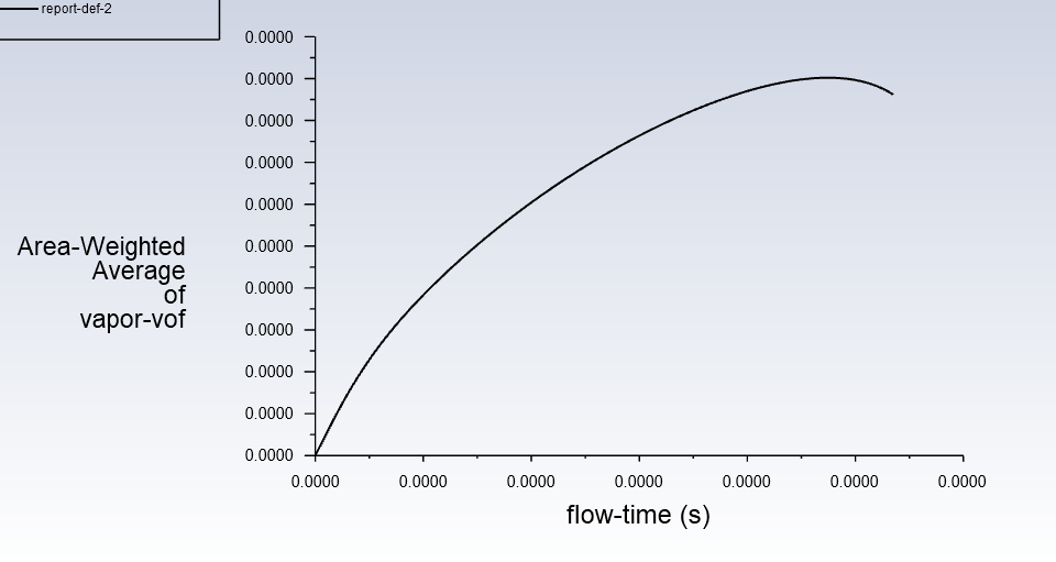

Also, another question what can be rason of vapor volume fraction is getting reduce after waiting a bit ? -

Ansys EmployeeHi,
For outlet pressure setting, you can check user's guide: 48.7. Boundary Conditions Task Page (ansys.com)
Plot is showing zero flow time and zero vof. Can you please recheck graph?
Thank you.
