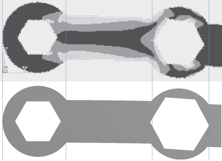

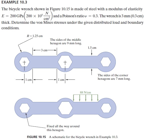

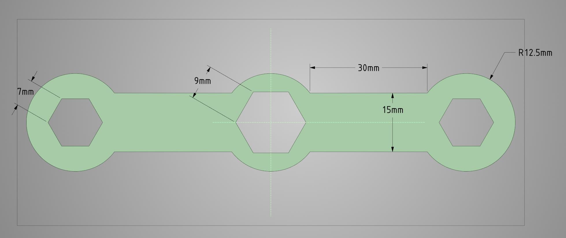

      I'm trying to reproduce Example 10.3 from the book Finite Element Analysis (3rd Edition) by Saeed Moaveni. The book uses ANSYS Classic but I am building the model in SpaceClaim.
      Note the hexagon in the center has sides with 9 mm length. The issue is that when I build this geometry in SpaceClaim, and compare it with the result in the book, the size of the polygon in SpaceClaim looks larger than the size shown in the book. I put the two solutions side-by-side and made the 3 cm lengths equal. Look at how much larger the polygons are in the lower figure, which is the SpaceClaim geometry.
      The larger polygon obviously allows a larger deformation under the same load.
      I would appreciate it if someone with ANSYS Classic skills would create the model geometry and attach it to a reply so I can see if ANSYS Classic gives the same size polygon as SpaceClaim.

      Here you go Peter, model and image.
      The SpaceClaim polygon is sized by the inscribed circle, not the outside, so I had to offset the polygon in 3D until the measured sides lengths were what I desired.
      F
      Frank, that's it!  Inscribed radius is the dimension.  After you said that, I looked more carefully at the Options - Sketch Polygon and it is as simple as unchecking Use internal radius to get the circumscribed radius!
      Thanks for the quick response.
