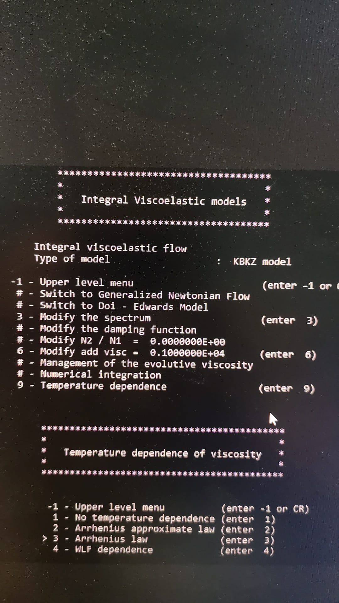

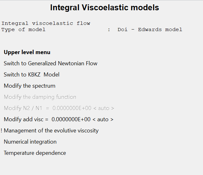

SubscriberHi, I tried to implement the Doi-Edwards model for an integral viscoelastic simulation for a shell model by switching to Doi-Edwards model in the "Material Data File" in Ansys polymat. After I saved the new Material Data File I tried to input the data with polydata_core.exe but I wasn't able to select "switch to Doi-Edwards model" (see picture). What can I do?

Ansys EmployeeHi,

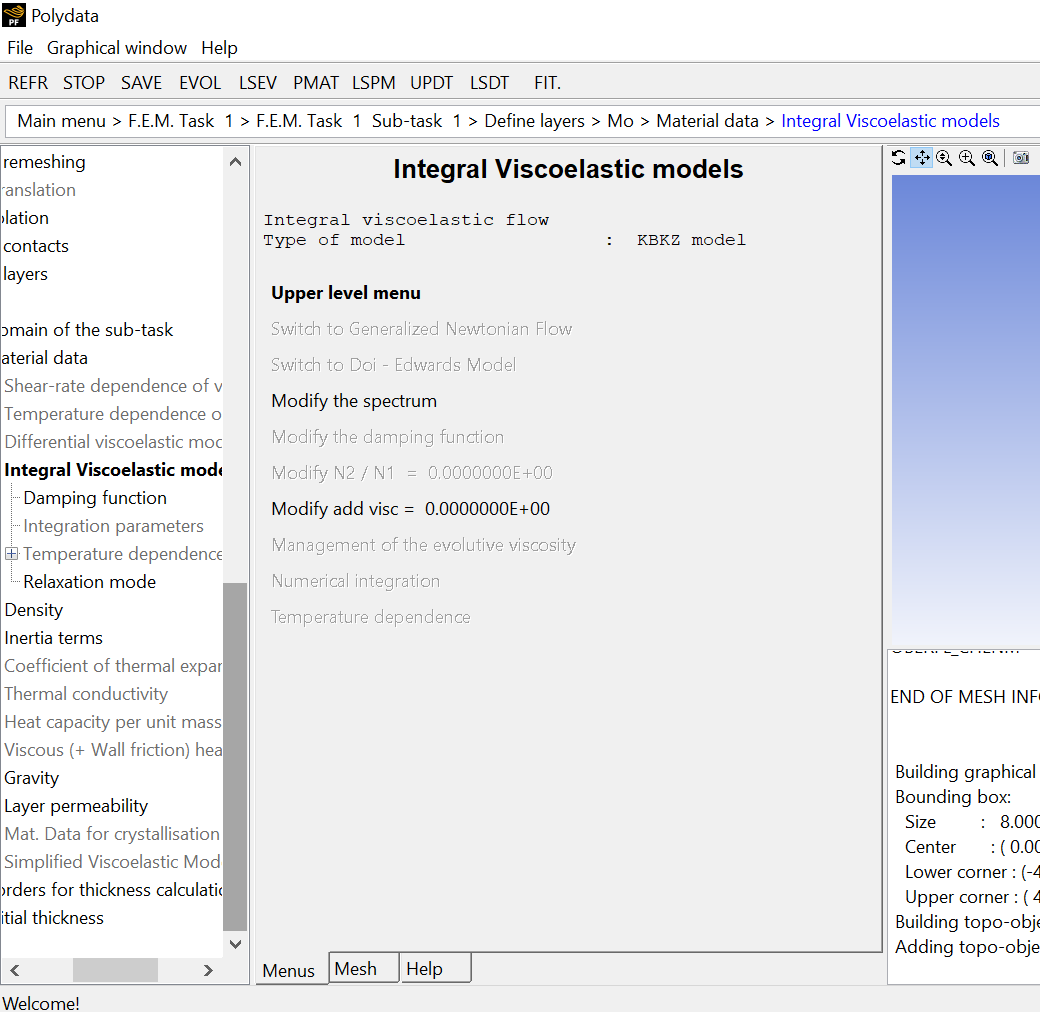

It shows the default KBKZ model. Can you load that mat file in polydata GUI and check?

Prashanth
Ansys EmployeeI see now. I think the Doi-Edwards integral model is not compatible with shell model.
