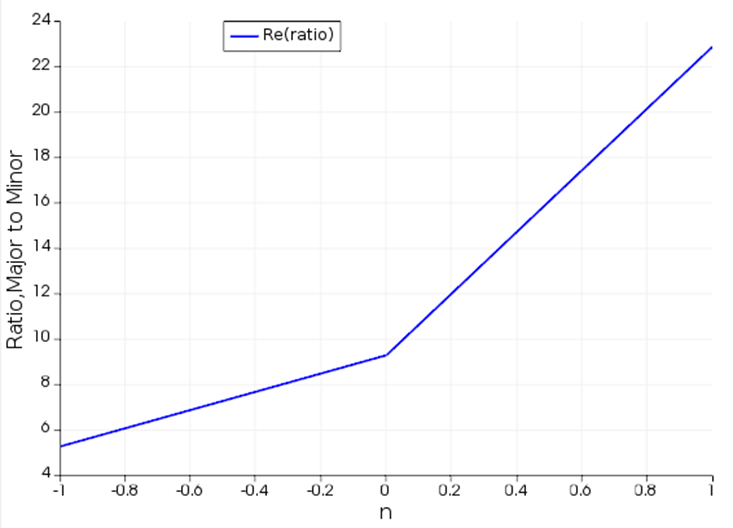

      (1) Polarisation state mean, as we know in FDTD plane wave source , we need to define the amplitude and phase difference for two orthogonal plane wave source for elliptical light. So i am looking for this that how to get amplitude and phase difference for each mode (at +45, -45 and 0 deg diffraction order) from polarisation ellipse analysis group?
      (2) Yes i want to use polarisation state of all the modes so that i can verify the reciprocity, right? and i should get the linear light back. so that means i need six plane wave , 2 plane wave for each mode. can i use all six plane wave in the simulation?
      Do you mean two plane source , with 0 deg and 90 pol input, a and b amplitude input, and phase difference which we can calculate from polarisation ellipse?

      A1: in the analysis group, it has ratio r=b/a and phase difference, thus, you will have 1+(b/a)*exp(i*phase) information.
      A2: When there is higher diffraction order, I am not sure how does the reciprocity can work: for a single-pair of plane wave, it is easy to have relative phase. When more then two are involved, it might be challenge. for example, you now have 3 pair of elliptical sources, and each pair works perfectly. However, what is the phase difference between them? This may need more thorough anaysis.
      are you sure the +1 order can create the diffraction to the previous +1,0 and -1 order? similarly for the -1 order.
      a+b*exp(i*phase) is a general description of a polarization state.

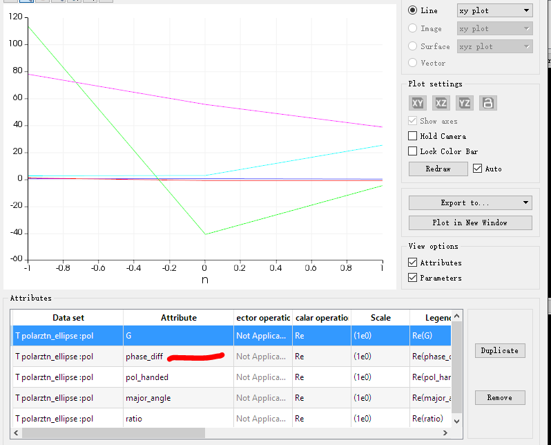

      I am referering the phase i am getting from here. this is from pol ellipse analysis group.
      What do you mean by "you get the original data from the analysis group and then process them accordingly"?
    • Guilin Sun
      This phase difference is between the two polarized light that compose the elliptical. However you have 3 pairs, how do you define their difference? eg 1: exp(i*phase1)*(1+(b1/a1)exp(i*phase_diff1))

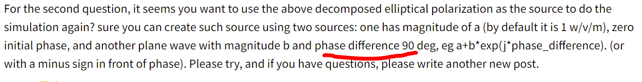

      So you will need to get phase1, phase2 and phase3 at the same time, and set the sources accordingly. eg,
      mode 1 : sources with amplitudes a1 and b1, phases are phase 1 and phase 1+phase_diff1;
      mode 2 : sources with amplitudes a2 and b2, phases are phase 2and phase 2+phase_diff2;
      mode 3 : sources with amplitudes a3 and b3, phases are phase 3 and phase 3+phase_diff3;
      This will completely recover all the original decomposed elliptical modes.

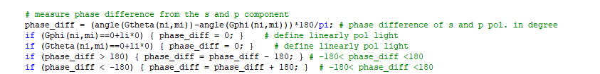

      From the script i noticed that phase difference is from this step:

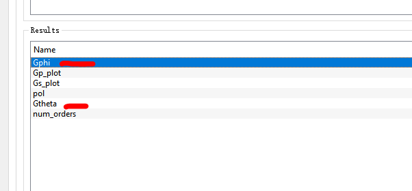

      Now, to calculate the phase for s and p component separately, i introduced Gtheta and Gphi here as follows:
      But the difference between them is not the same as in phase difference calculated from here:
      I think it should be the same? Am I approaching it correctly?
    • Guilin Sun
      Please note that Gtheta and Gphi are field quantities, not angles. Calculating their phase difference is a little subtle, as you can see from the above screenshot.
      You do not need to re-calculate them, just use Gtheta and Gphi as two sources: each has its abs() and phase angle().
      If you do not think it carefully about how to excite the device with decomposed fields, you may suffer difficulties to get what expected. Please discuss with your colleagues or supervisor, as there are more theoretical issues. we are here to help you for simulation only.
