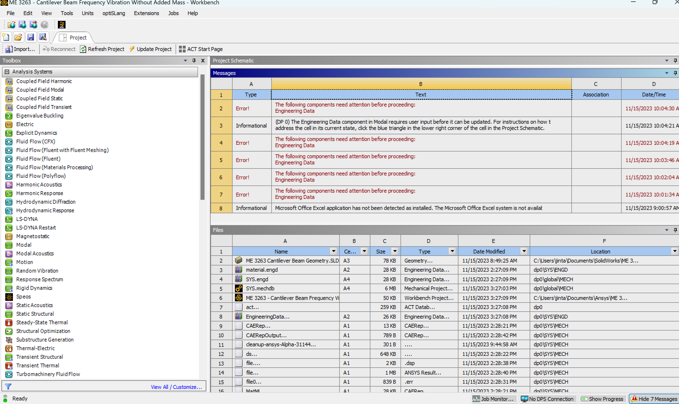

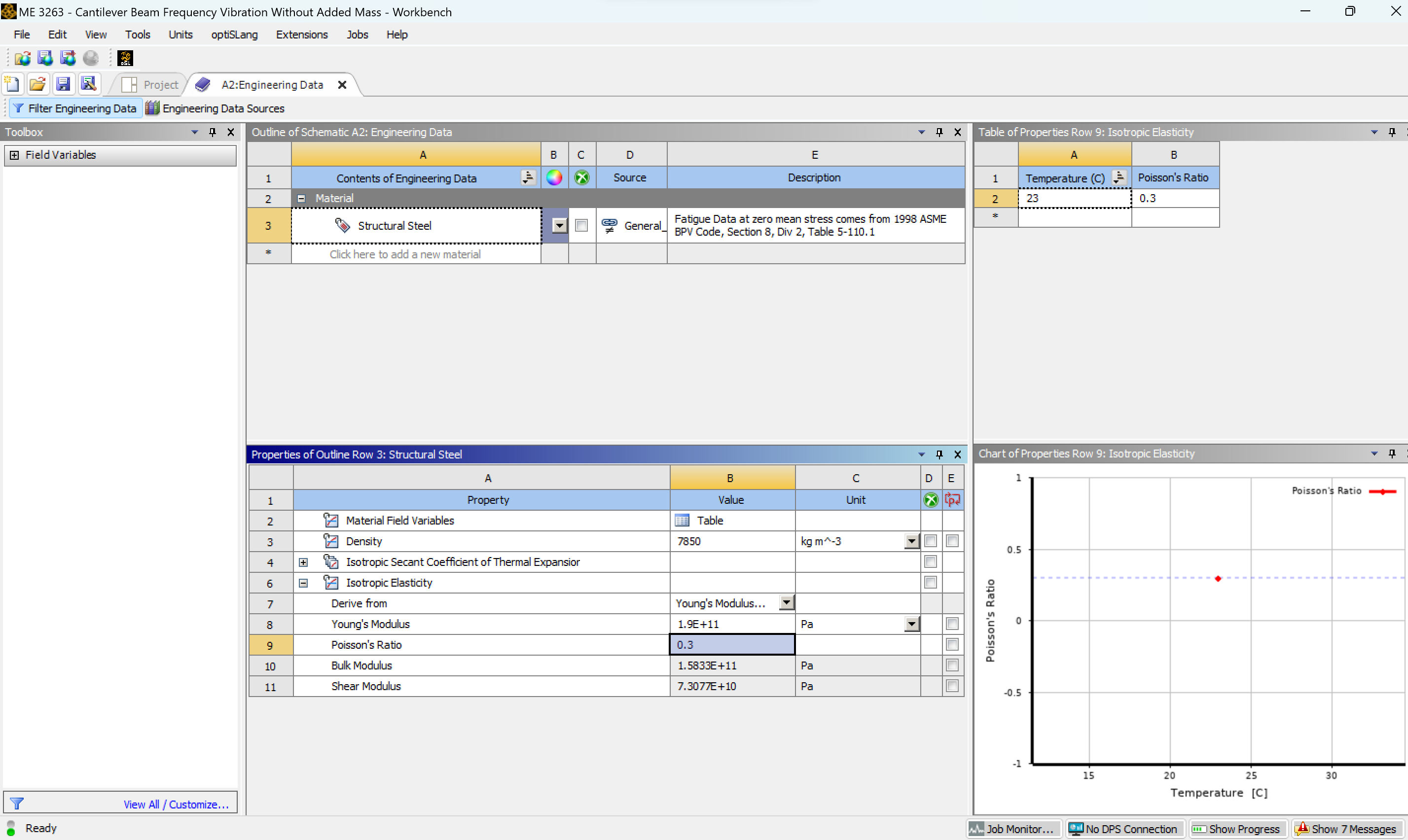

      I went to 'Engineering Data' and changed the Poisson's ratio from 0.3 to 0.5. Then an error message would pop up every time I click on 'Model' and won't let me get in. Why does a parameter cause this much of a problem?

      Not sure we can have 0.5. Can you try with 0.4 and 0.49 to see if it works.

        It works now. But why wouldn't the workbench solve for 0.5? Memory issue?
