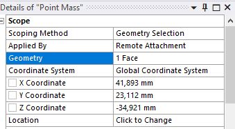

      Hello guys, I have one question, what is the difference between the geometry and the location in the point mass menu. Thanks for your help.
      The coordinates define where the point mass is located.  ANSYS will create a set of connection elements from that point to nodes on the Face identified in the Geometry field.
