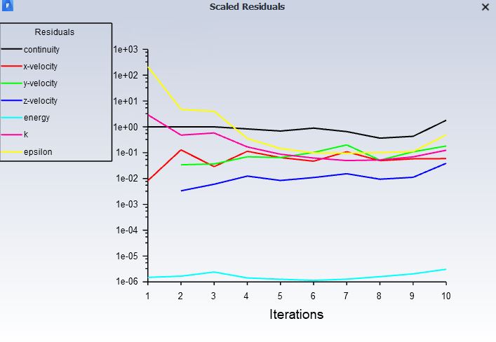

      Hi Karthik,n Thanks for the reply. I am using Standard Initialization. I selected in the Compute from option all Zones and gave a temperature of 31 degC. Because my setup is at 31 degC and the operation begins from 31 degC. nI am using a transient Solver. I am solving for a time step size of 3600 seconds and the number of time steps is 1. The number of iterations is 10. Can u tell how do I know if I have converged my solution? I have provided the Scaled residuals of my simulation below.nnMy Boundary's consists of contact regions, walls, interiors, inlets and outlets. I have applied a temperature of 31 degC for the environment. I have created a box around my setup which is my environment and have assigned material properties of air. The 31 deg C I have applied on the wall of this box. nThen I have inputted the temperature and mass flow rate for inlet and outlet. I have used mass flow inlet and mass flow outlet as my boundary condition here.nThe rest of the boundary conditions I have left it untouched.nI used k-epsilon viscous model for my simulation.nI have given a list of my boundary conditions as an image here.nn

      You need to create a Report Definition (look in the tree in the Solution section) for temperature for each point of interest in Fluent. Then run the calculation. If you set up the monitors correctly (see the tutorials for examples) you'll see the plot of temp v time and if you tick the write to file option you'll get text files written out too. n
