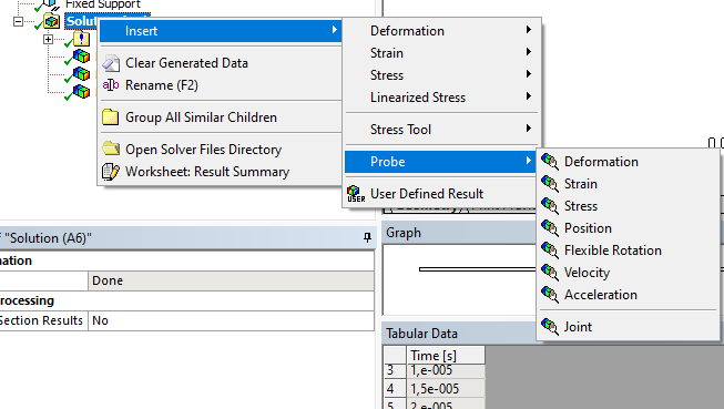

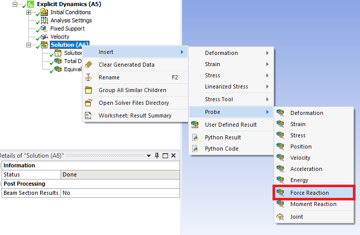

Rafael Gomes
SubscriberThank you very much for your answer.
In this case, using Autodyn, it does not give me any option to select the reaction force. I found the force reaction in the “probe” option, but only in the “mechanical” for the static analyses.
Do you know if it is possible to evaluate the force in explicit dynamics? And posteriorly plot the Force x Displacement?
Thanks in advance! -
January 23, 2024 at 3:18 pm
January 23, 2024 at 9:44 pm
peteroznewman
SubscriberUse a Translation Joint to move a rigid body to compress the honeycomb core using a Displacement Load. Then Probe the Joint for the Reaction Force.
