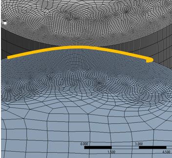

      I am making a ansys project and encountered some problems. Hope you can give me some advice
      There is a contact between 2 rollers. Now I want to plot the grapth of the pressure distribution on the contact area
      Interns of on the direction along the rollers, we can sketch a straight line and plot the results along that path. How about in the perpendicular direct (along the nip width – the highlight curve) it is a curve, how can we plot the pressure distribution in this direction (or plot a result along a curve)
      Thank you very much.
    • Sandeep Medikonda
      Yes, you can also plot the frictional stress using the Contact Tool. Please see this section from the help.
      For the latter question, yes you can define a construction path/surface and assess the results as well. Please see this section from the help and this video from about the 10 minute mark.
      https://www.youtube.com/watch?v=mQFsEcK-jII
      You might find this article useful as well.
      Sandeep
