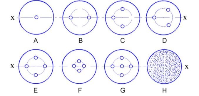

Subscriber The gas sparging pipes were not really modelled instead a gas mass source was imposed at the locations of the gas sparging pipes so that the numbers of mesh used in the sim

March 7, 2022 at 5:11 pmsafwan_nasir
Thanks for the reply. Let me further explain my problem. Actually I'm currently using this mesh. I want to make structured mesh to reduce computations.
These are the inlet face sections (1mm diameter each) from which air is injected into the water column. From different papers I have read that "they do not model these sections but create mass point source instead". I shall be very thankful if you guide from ab initio as these things are new to me or please suggest me any guide source from where I can follow complete steps. Thank you again.

Ansys EmployeeSo a sort of sparger: the easiest way is to go back to Meshing and create dedicated named selection for this faces or do what mentioned. Perforated walls won't work as your gas phase is secondary phase.
If you do not expect any accumulation and large volume fractions you can even use DPM and code a your injection to just inject gas from the requested inlets.
