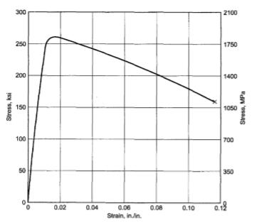

      Ok, I refine my question. Consider material stress-strain curve like this:
      Which material model should I use for that?
      Also which model can describe softening after yieldnig point and strain rate dependence of material?

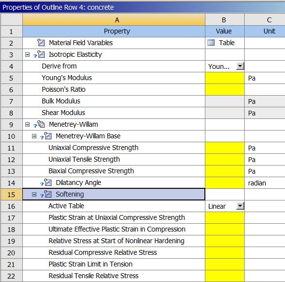

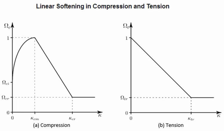

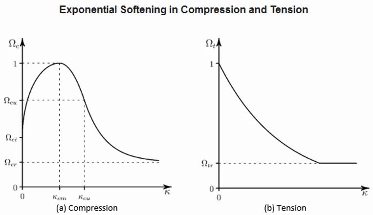

      In the Geomechanical materials library is the Menetrey-Willam model. It has two versions of material softening: linear and exponential, but has a different response in tension than in compression. This material model was developed for concrete which has little tensile strength.
      Note: you have to add Linear Elasticity for the linear elastic response, and also the Menetrey-Willam model, and after you add that, the Softening option becomes available in the Toolbox.
      Regards, Peter
    • holmesthinking
      This is what I search for. Thank You for help.
